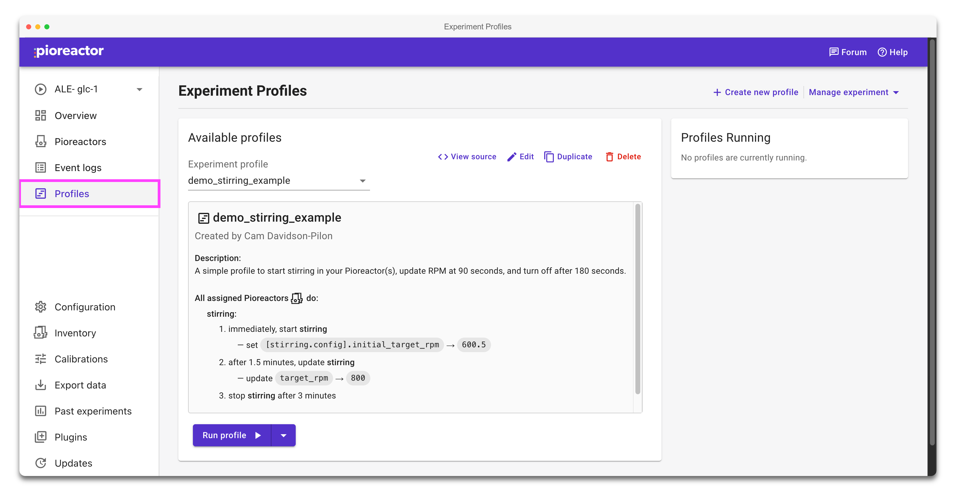

  1. Open the Profiles tab. In the sidebar, choose Profiles under the current experiment.
    Profiles tab highlighted in the sidebar

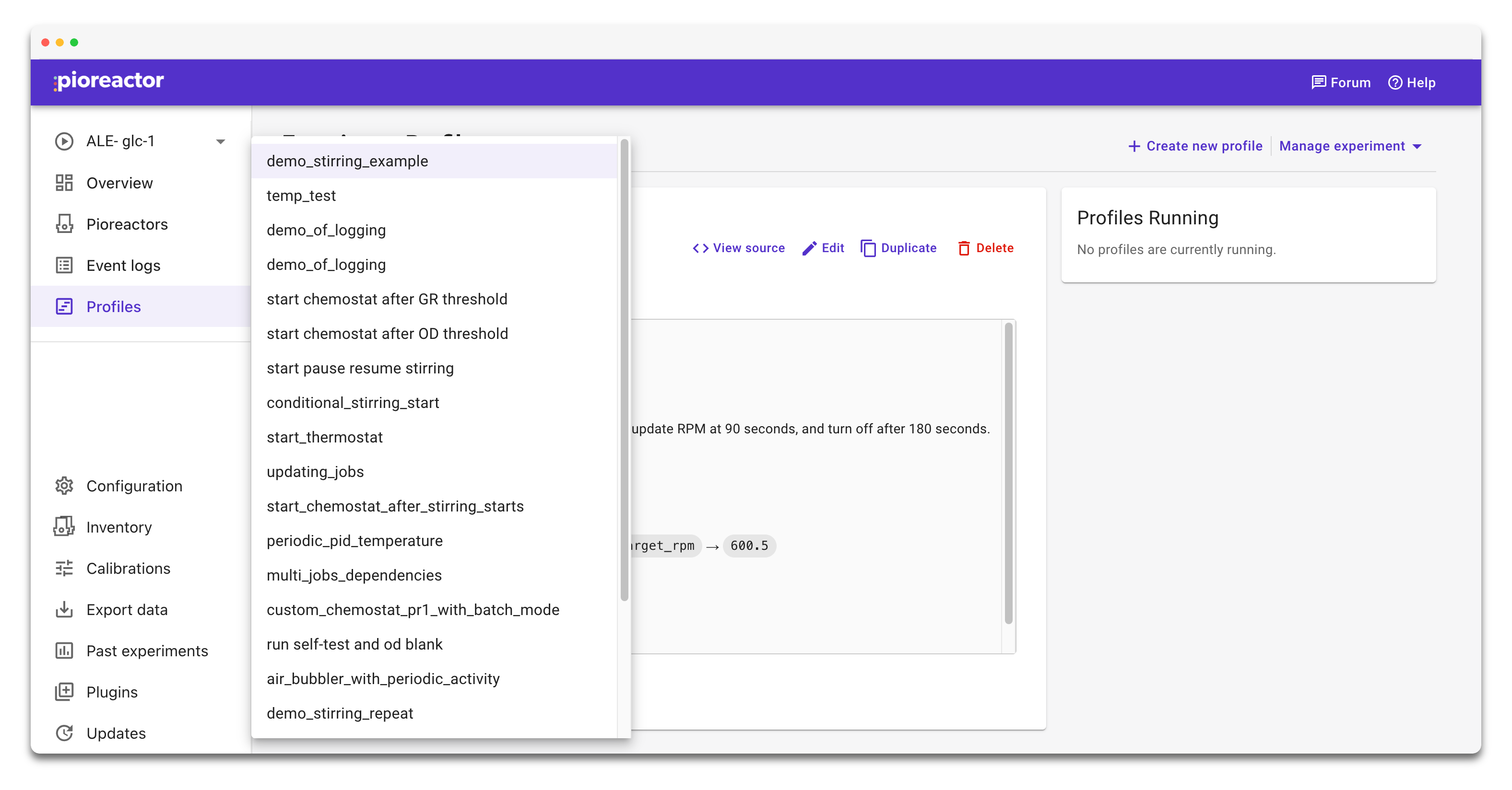

  2. Pick the profile to run. Use the dropdown to select the YAML profile you want to execute.
    Profile dropdown highlighted in the Available profiles section

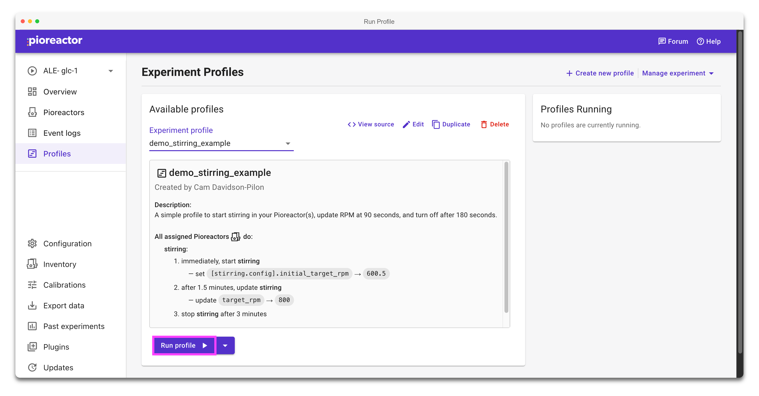

  3. Start the profile. Click Run profile to launch it immediately.
    Run profile button highlighted

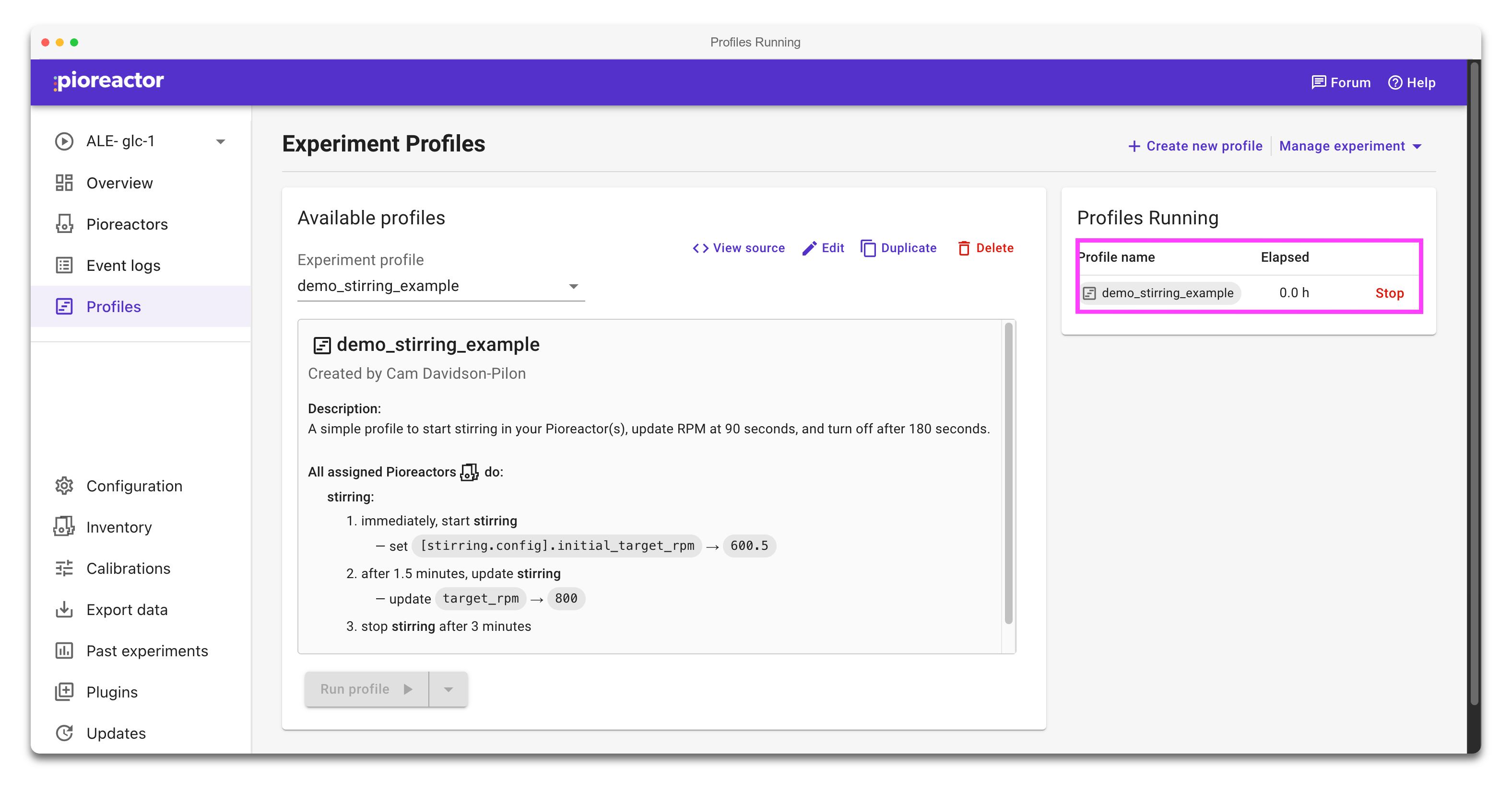

Monitor and stop running profiles​
Once started, profiles appear in Profiles Running with a link back to their definition and elapsed time.
Profiles Running table highlighted with an active profile

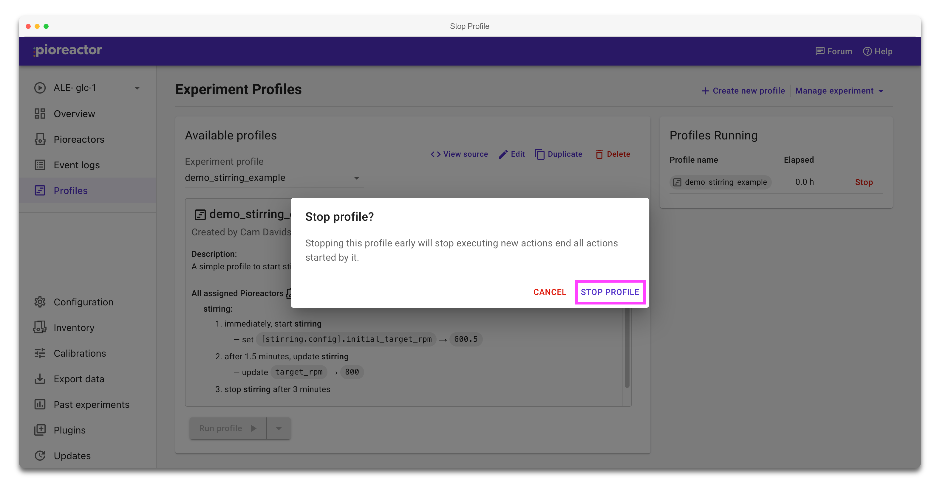

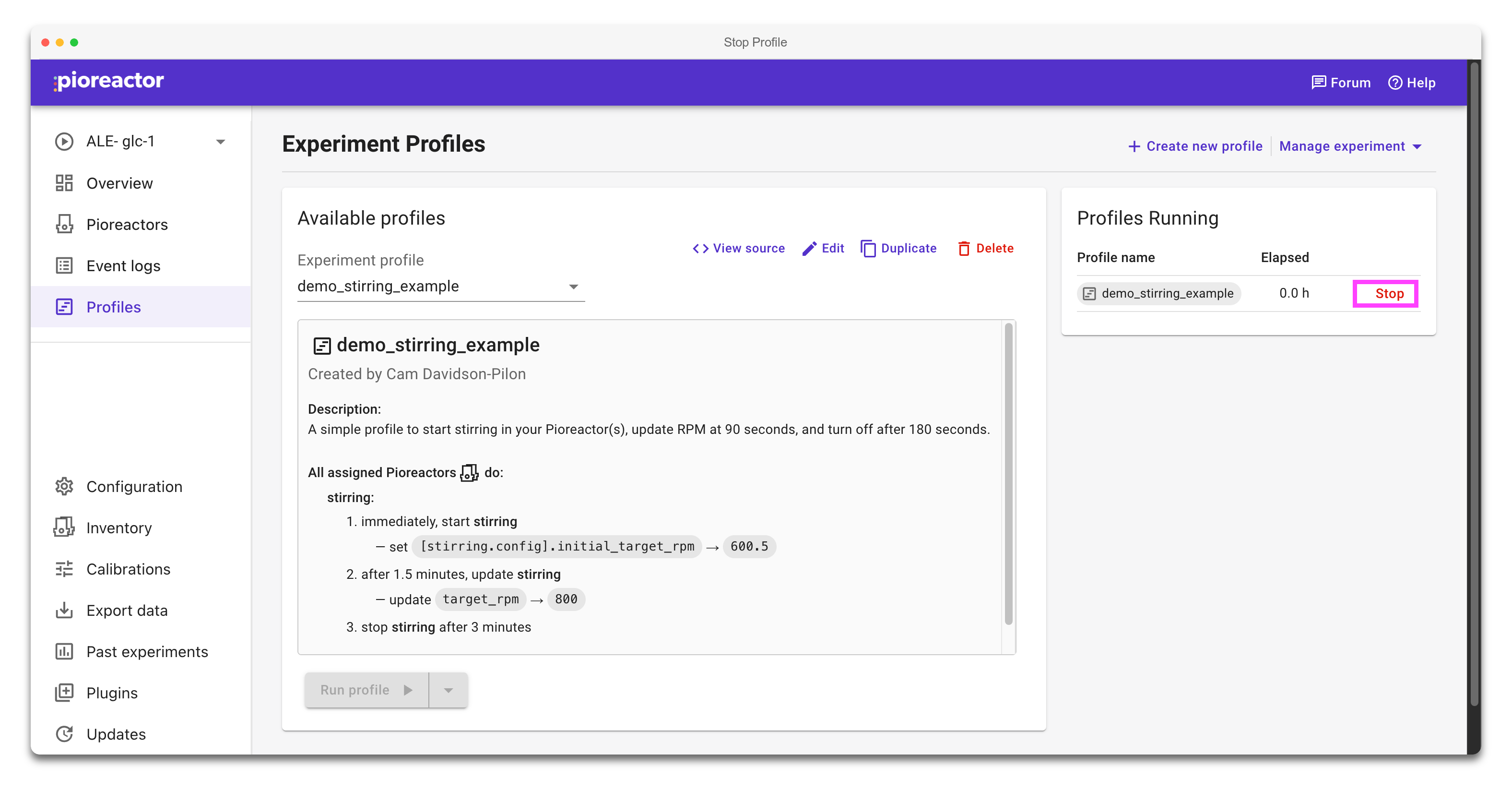

When you need to stop a profile early, use the Stop button in that table. Confirming the dialog terminates all actions the profile started and prevents any queued steps from running.
Stop button highlighted in the Profiles Running table
Stop profile confirmation dialog with the Stop Profile button highlighted
