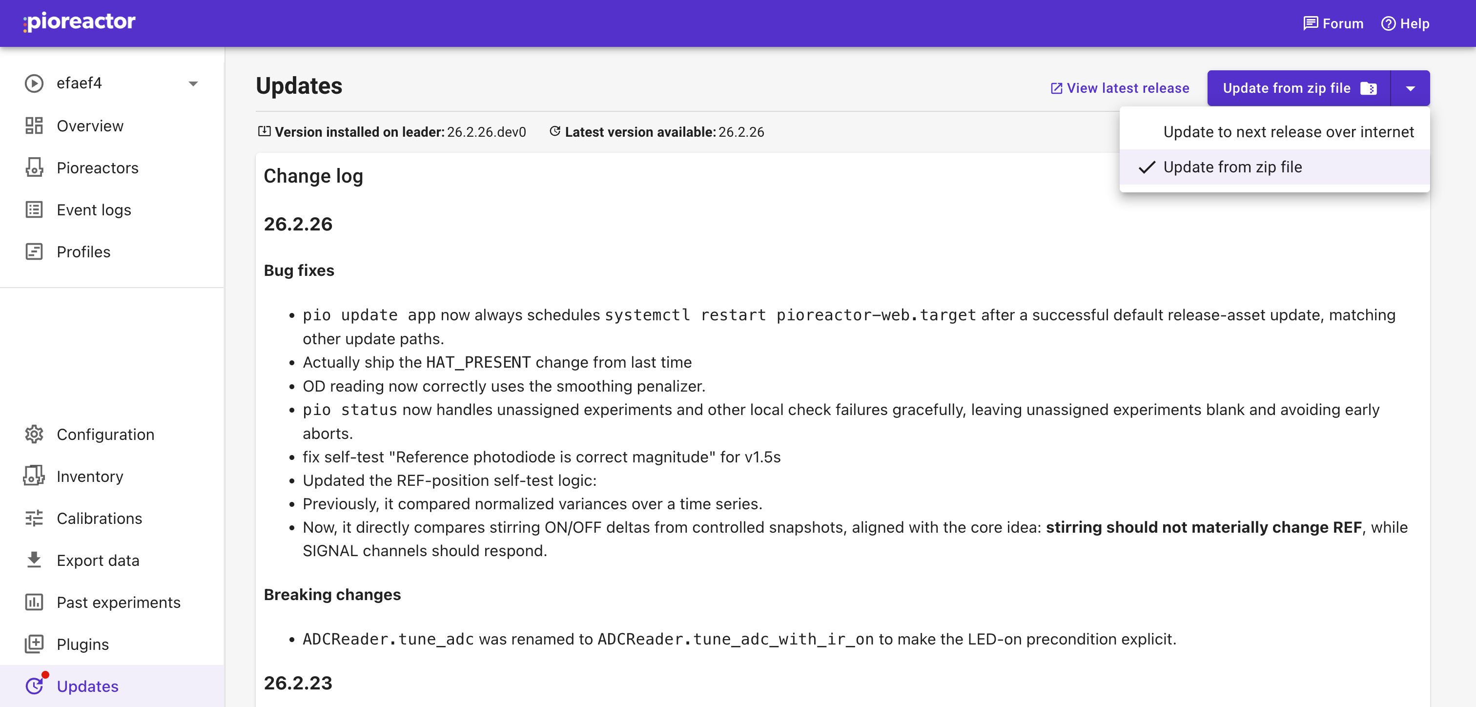

  2. In the UI, open Updates. In the dropdown at the top right, select Update from zip file.
Updates page dropdown with "Update from zip file" selected

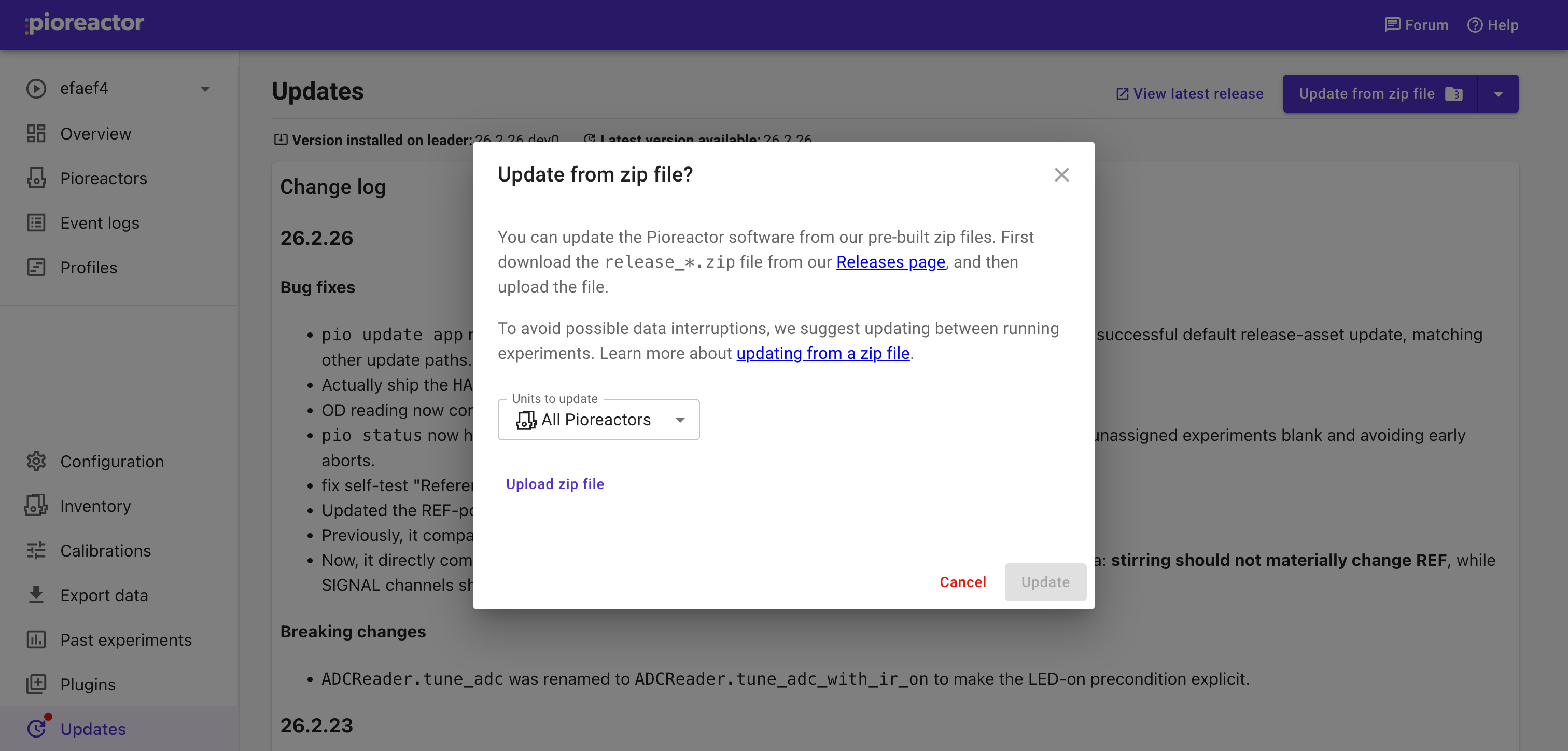

  1. In the dialog, click Upload zip file.
Update from zip file dialog with the "Upload zip file" option

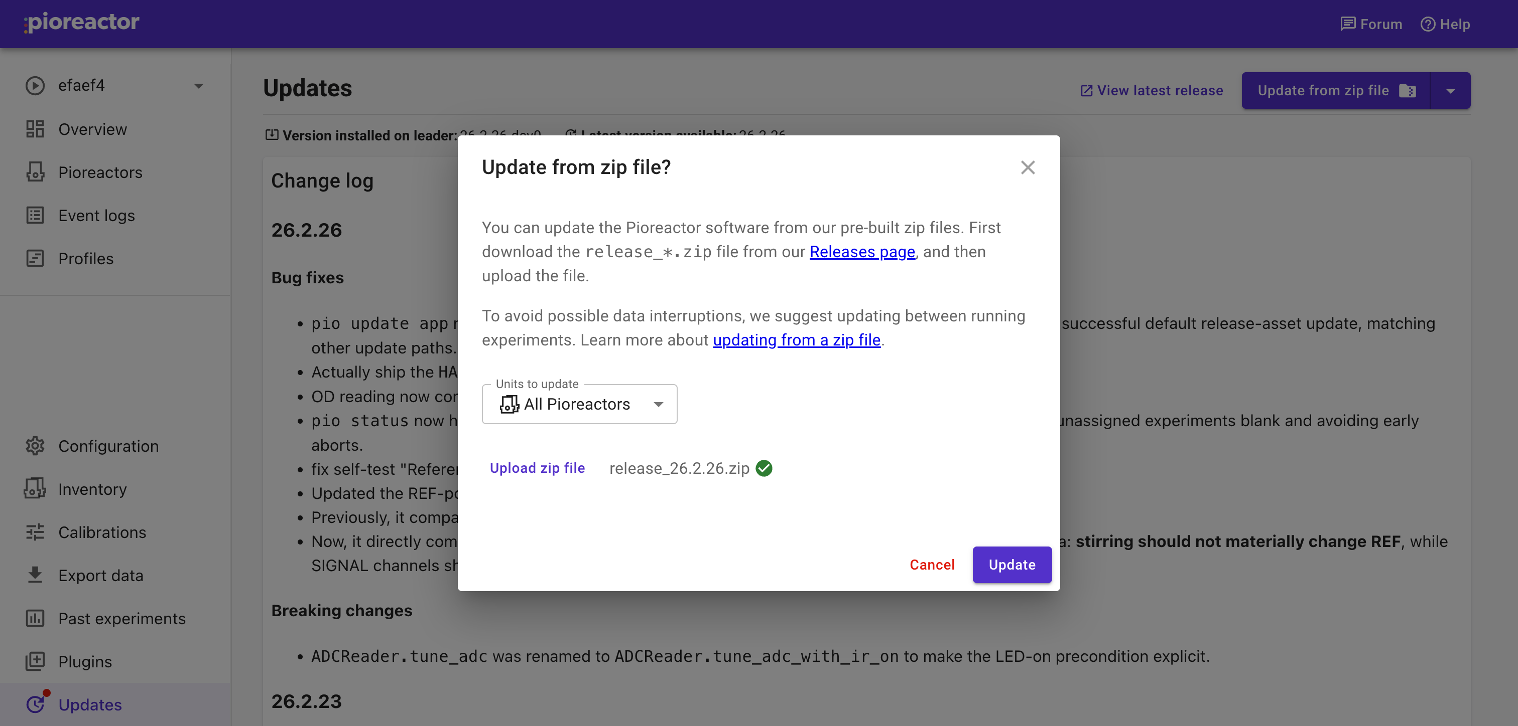

  1. Select the zip file from step 1 (release_xx.xx.xx.zip).
  2. Confirm the filename appears in the dialog, then click Update.
