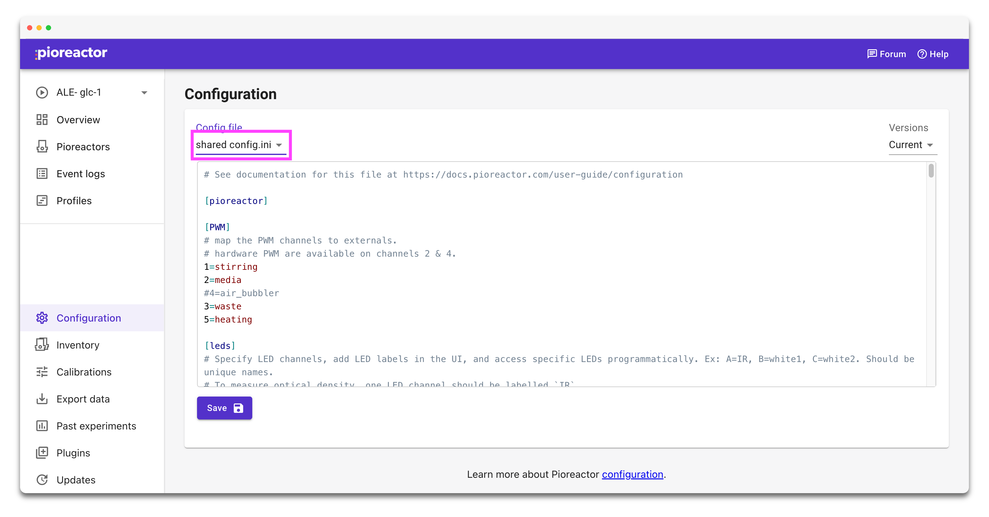

At pioreactor.local, navigate to the Configuration page in the sidebar.
Edit configuration page
Select the configuration file you wish to edit from the dropdown:
Choose the config.ini you wish to edit

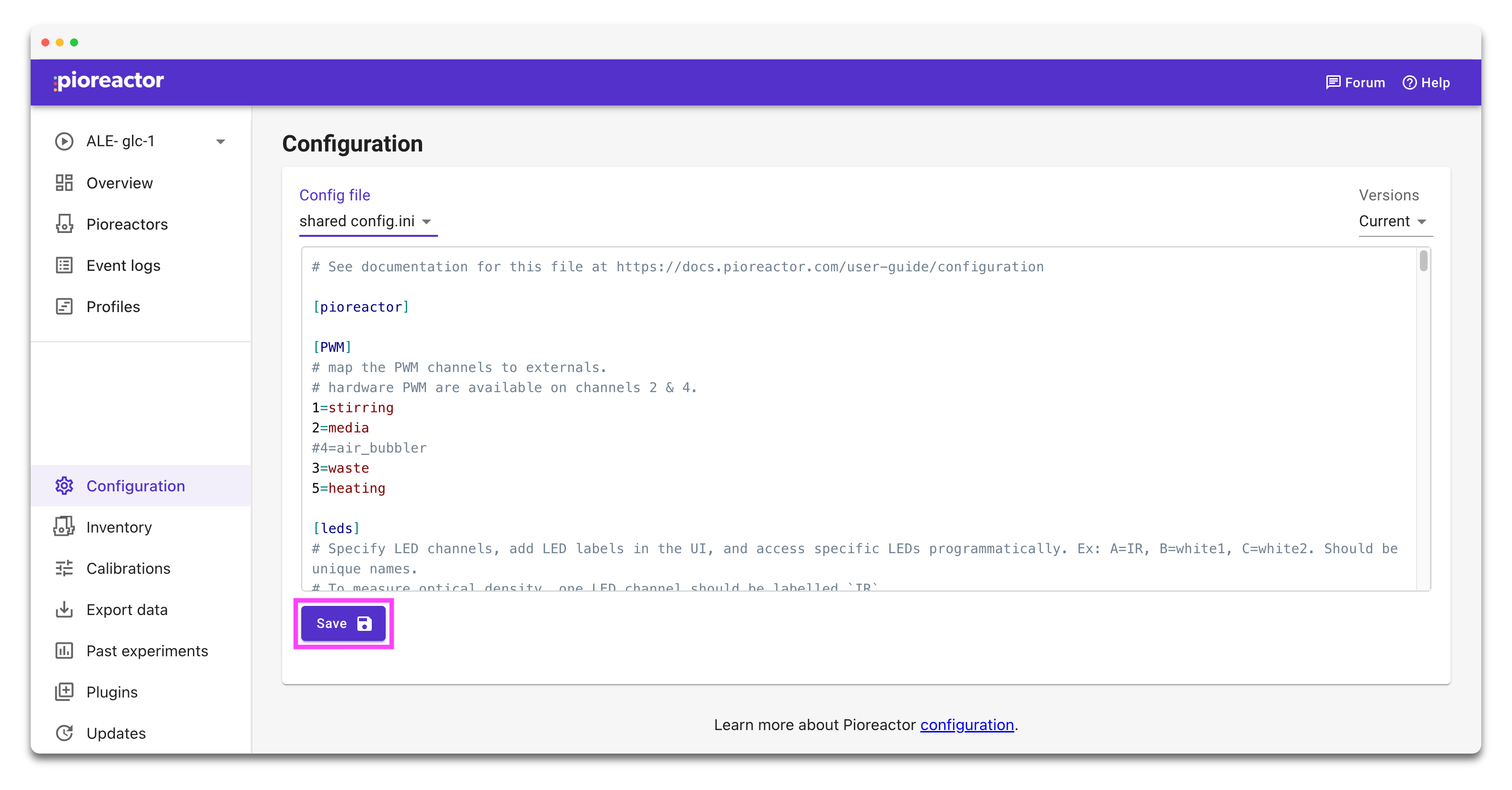

Clicking [Save] will save the new configuration and will deploy the new configuration to the proper Pioreactor unit(s).
Save the edited config.ini using the Save button

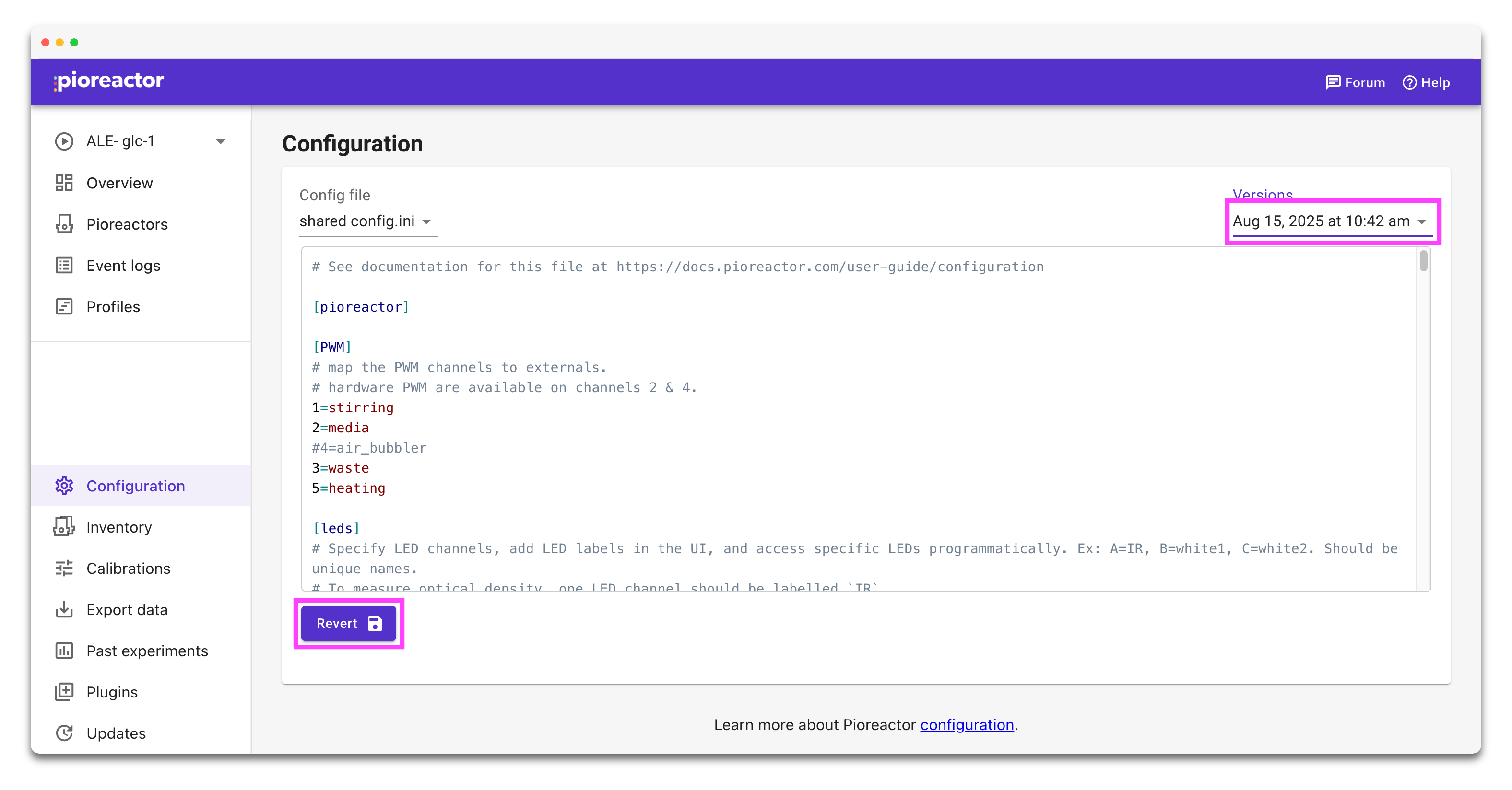

Pioreactor also stores a history of changes to each configuration file. You can view previous versions of configuration files in the dropdown. Clicking [Revert] will save the displayed configuration file.
Select historical versions of config.ini's
