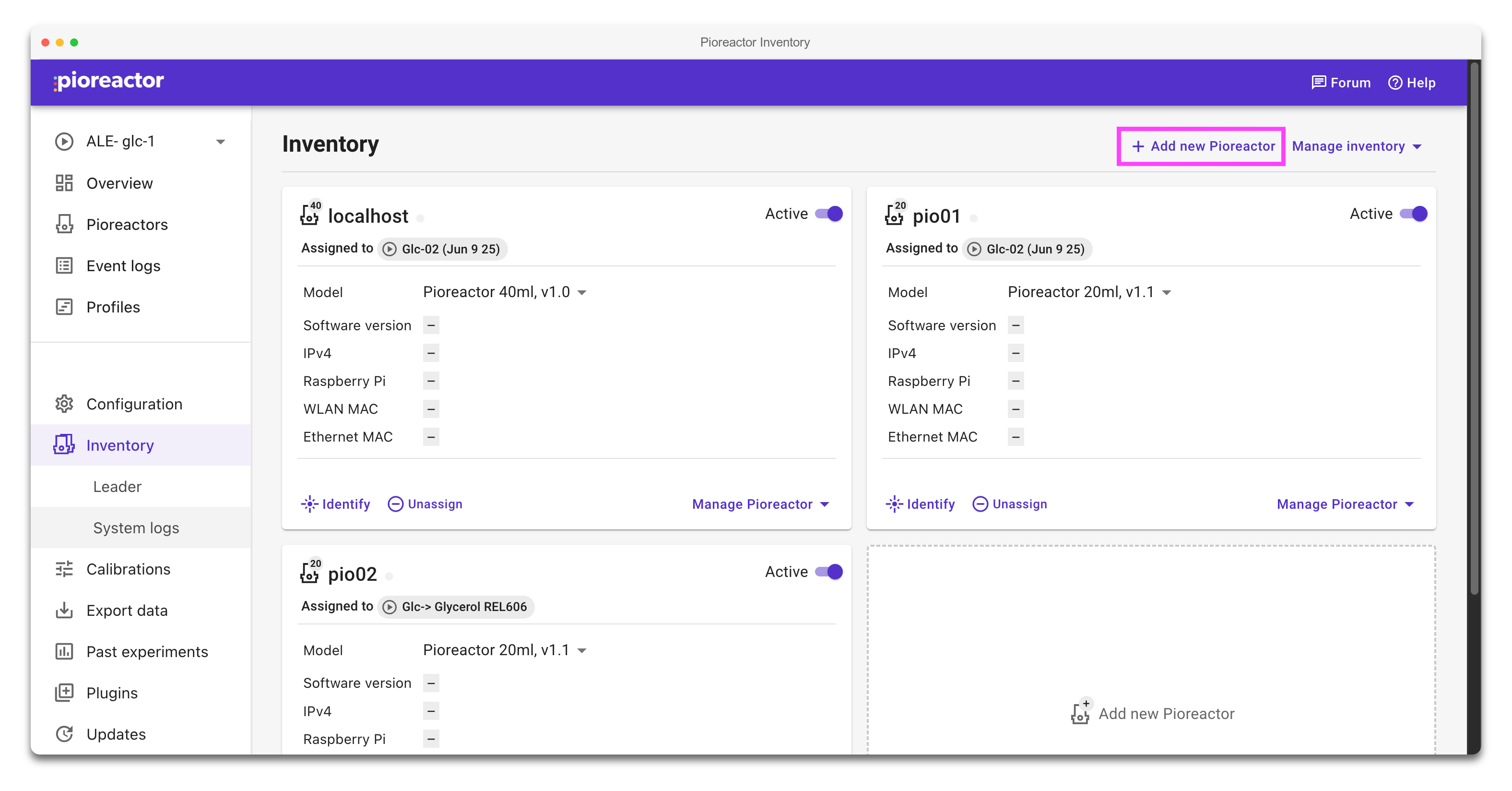

On the Inventory page, you can search for and add worker Pioreactors to your cluster. Click "Add new Pioreactor" at the top right corner of this tab.
Inventory tab with the Add new Pioreactor button highlighted

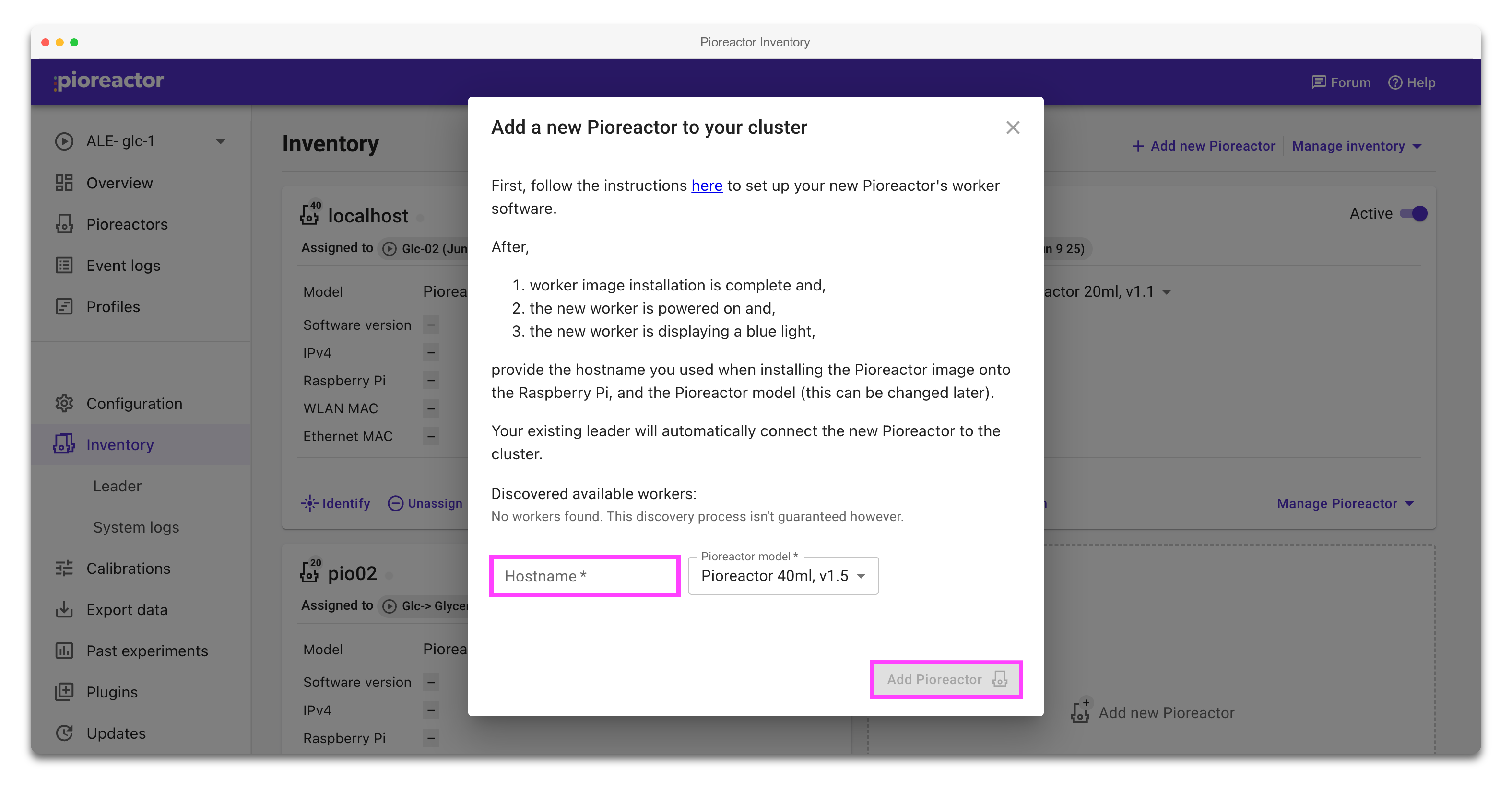

In the popup, add the name of your worker and click "Add Pioreactor".
Don't know what model you have? Compare it to the images in Getting started.
Add Pioreactor modal with hostname and Add Pioreactor button highlighted
Keep the dialog open while setup runs. If a step fails, correct the reported problem and retry adding the same worker. A wrong SSH password fails immediately; check that it matches the password configured when writing the worker image.

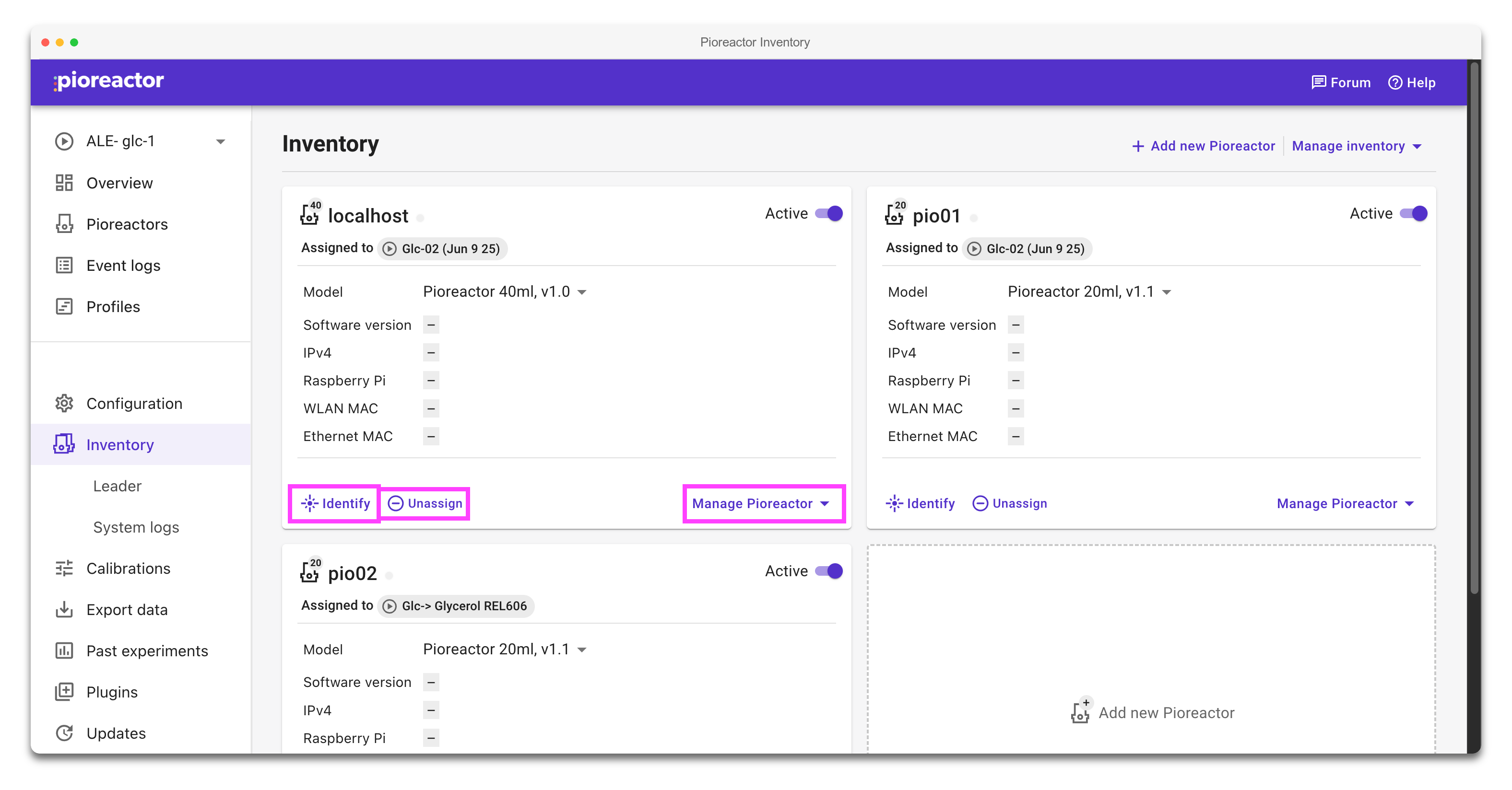

This Inventory tab will display metadata pertaining to each of your Pioreactors. You can use this page to identify a Pioreactor (causes the blue LED on the HAT to blink), unassign a Pioreactor from any experiment, reboot a Pioreactor, or remove it from your cluster. This page also provides a summary of which Pioreactors are assigned to which experiment, as shown in the image below.

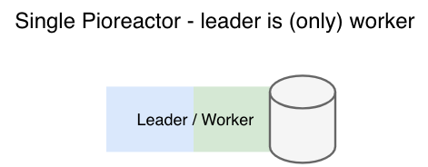

Single Pioreactor​
The simplest topology is when you have a single Pioreactor, and by default it is both the leader and the only worker.
