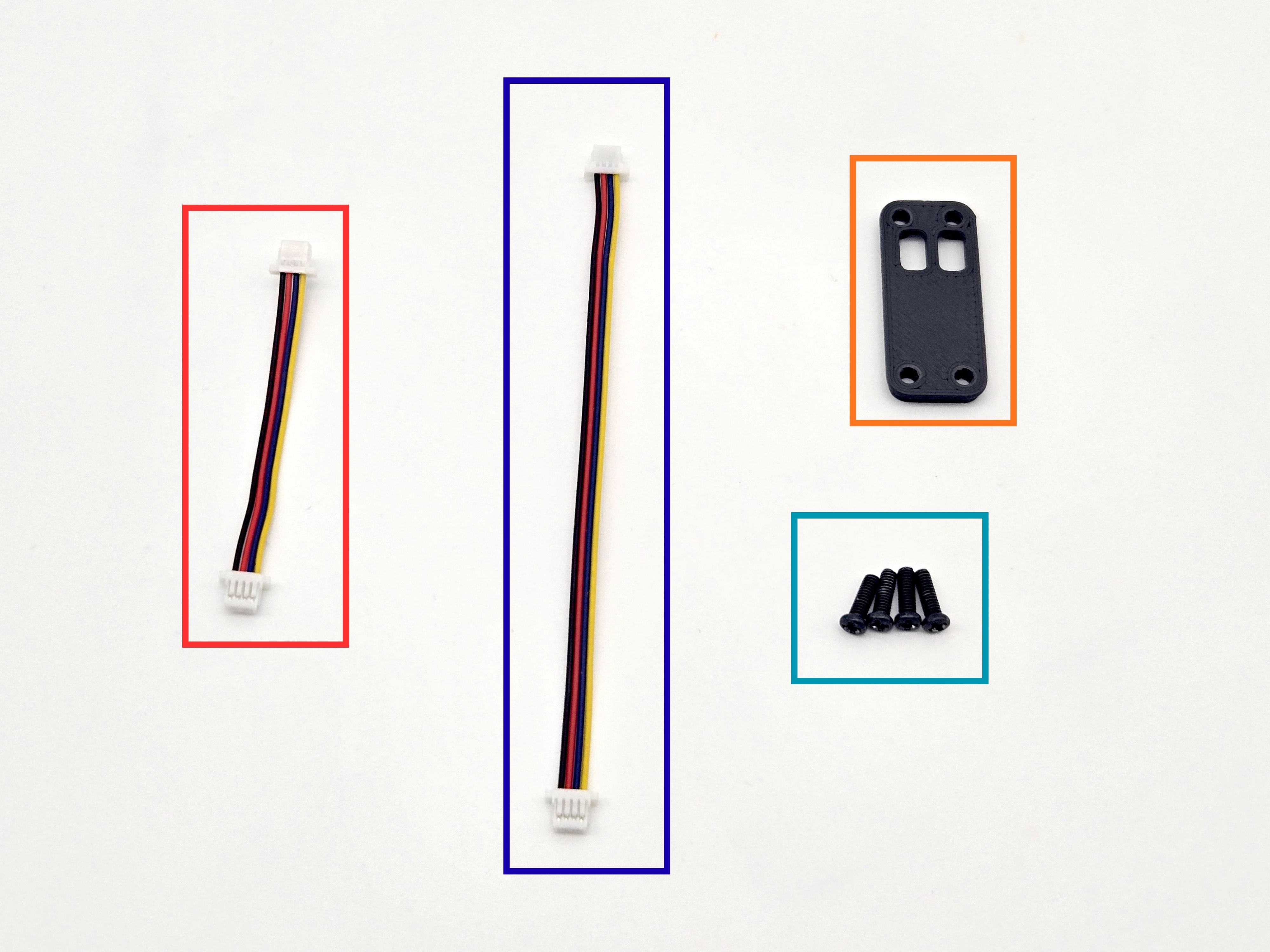

  1. You will receive the following items in your upgrade kit:
  • 1x Eye-spy (address: 0x48)
  • 1x Eye-spy (address: 0x4B)
  • 1x 50mm STEMMA-QT wire
  • 1x 100mm STEMMA-QT wire
  • 1x Optics cover
  • 4x 8mm screws

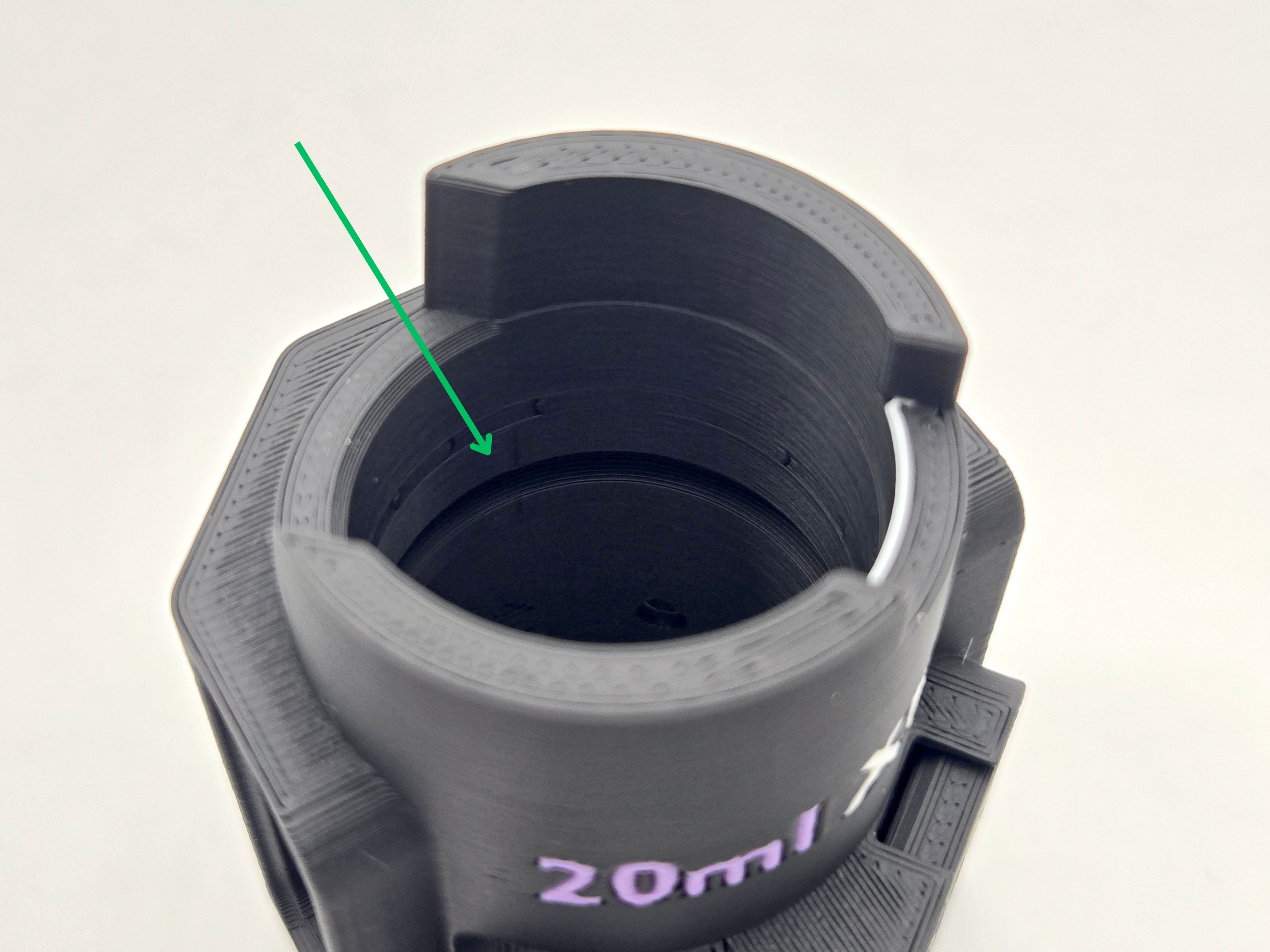

  1. The XR top vial holder has a groove within the body where the #024 O-ring sits. Carefully insert the O-ring using your fingers. Make sure to not twist the O-ring.
  2. Run your finger inside the vial holder, pushing the O-ring into place to ensure a snug fit.

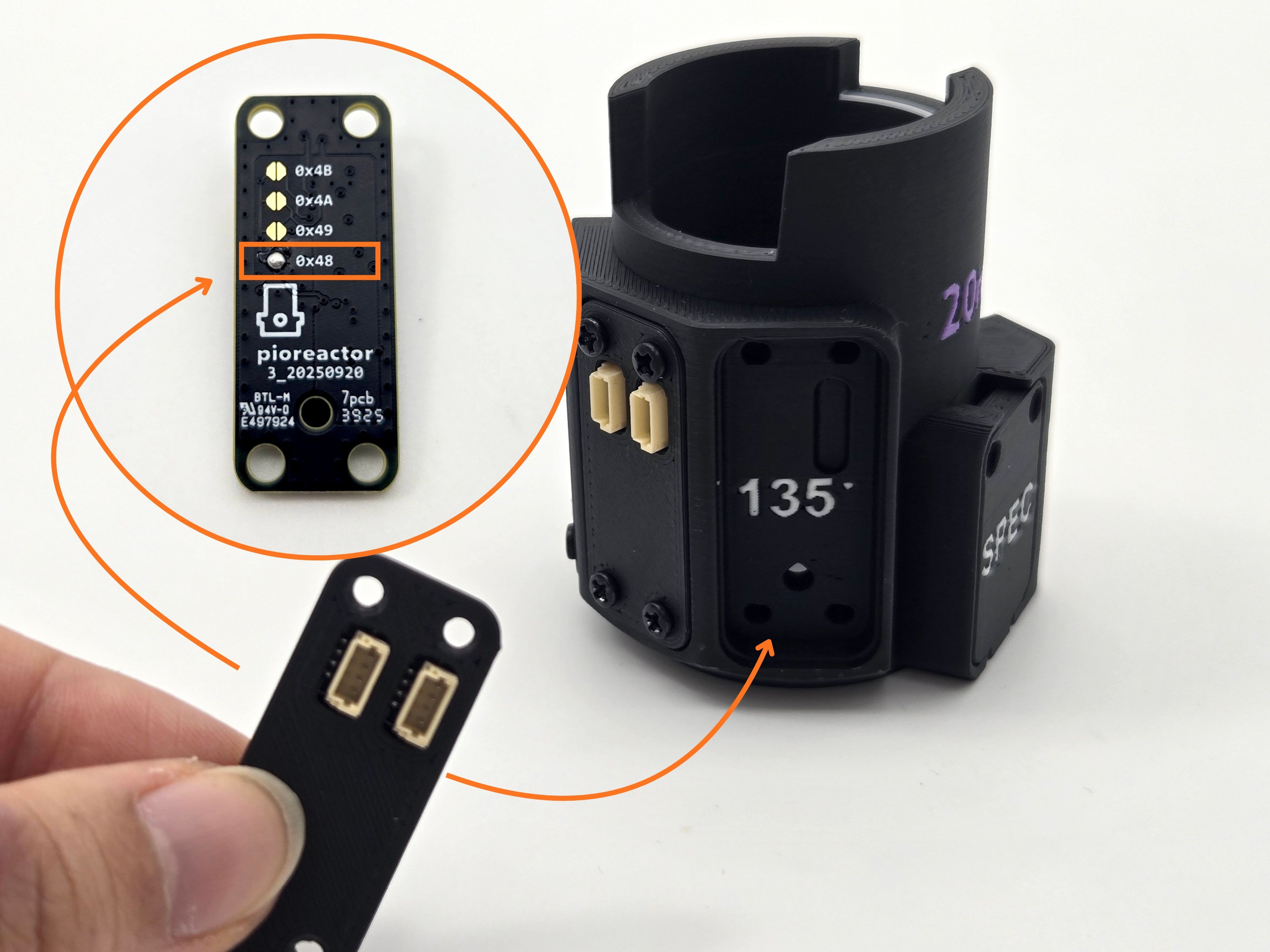

Step 3: Attach the eye-spys #

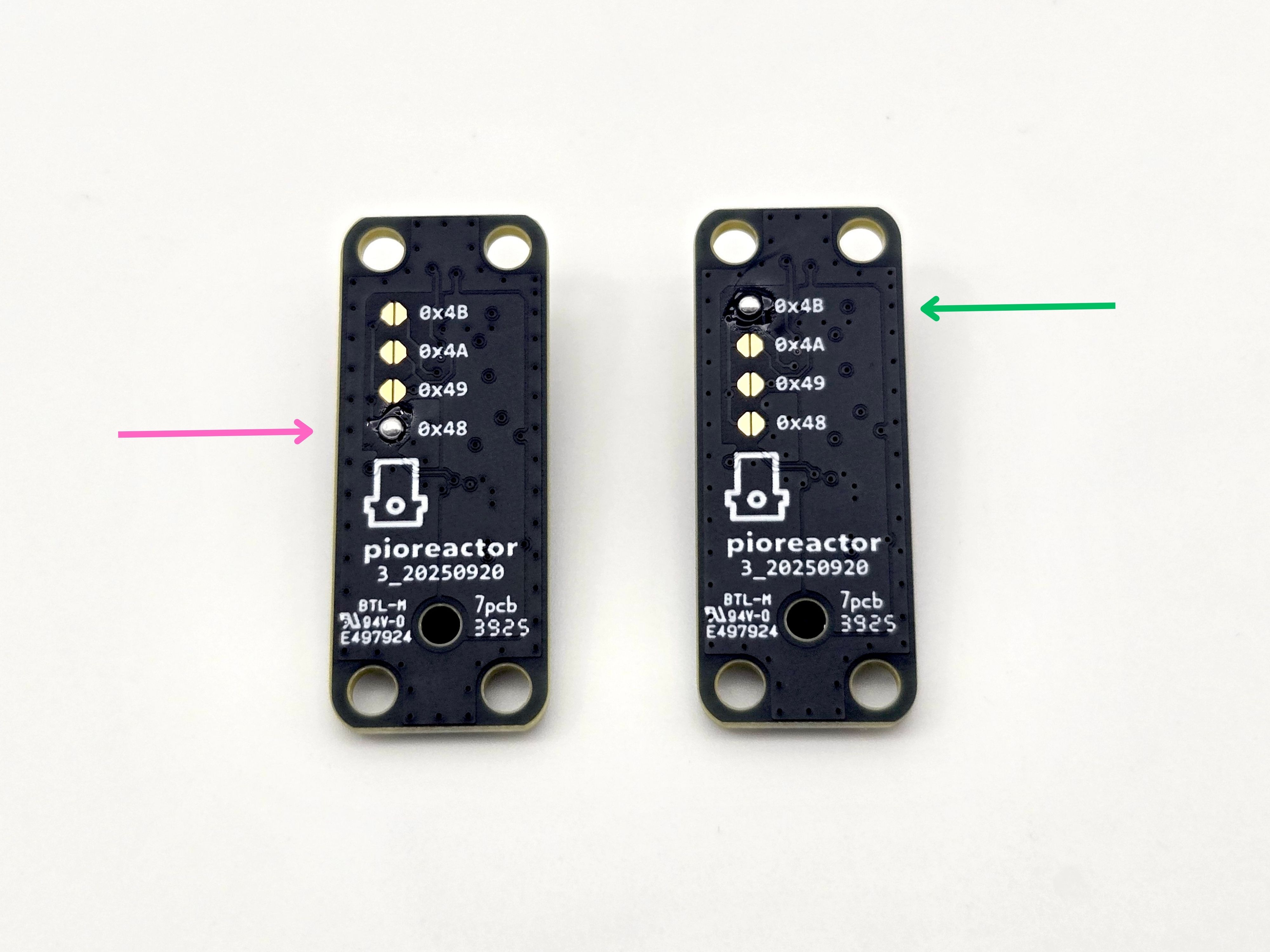

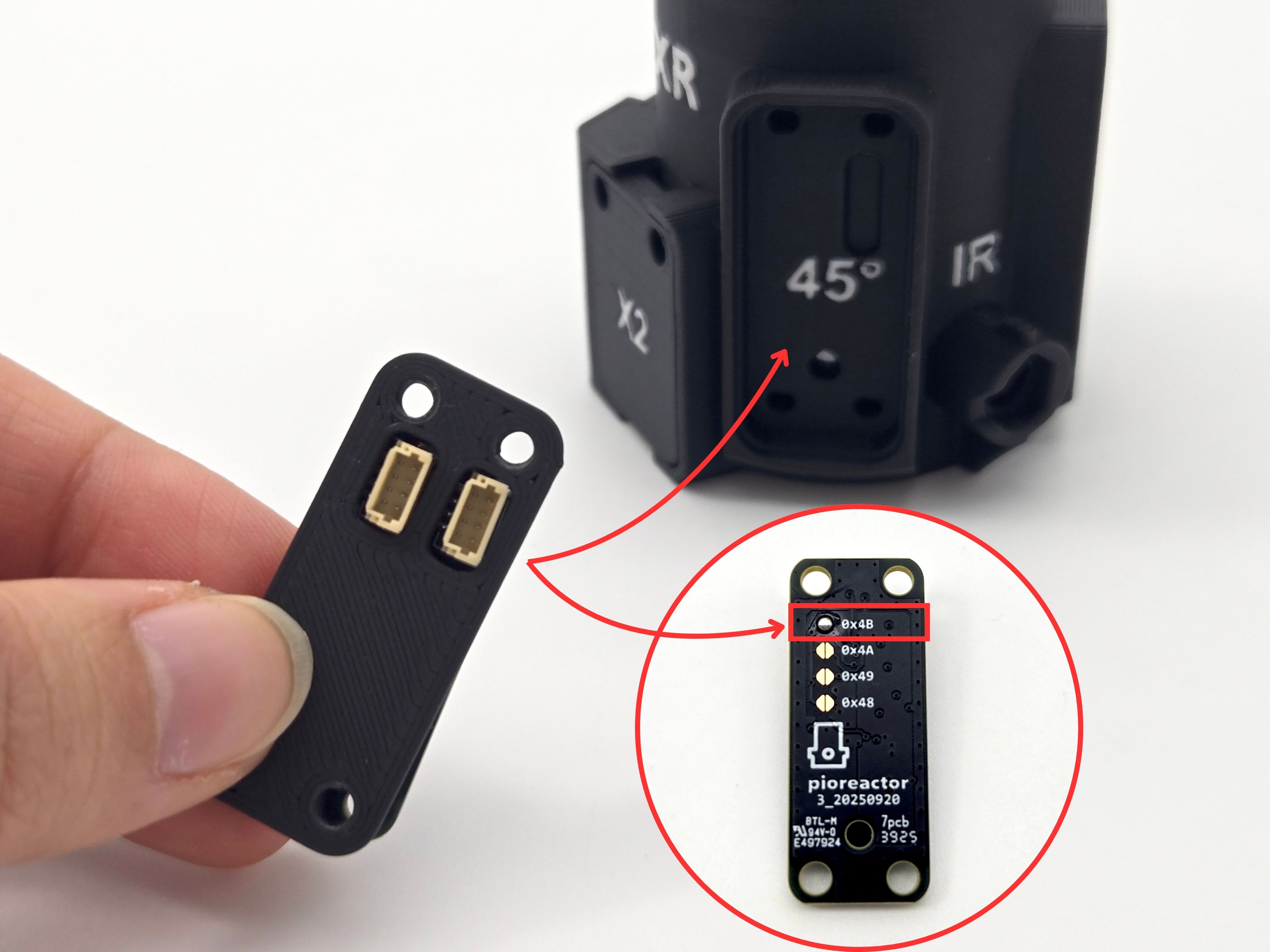

  1. Identify the eye-spy with the address 0x4B. Look for the soldered bulb next to the top address.
  2. Place the optics cover over the eye-spy, and secure it in the 45 degree pocket with 4x 8mm screws.

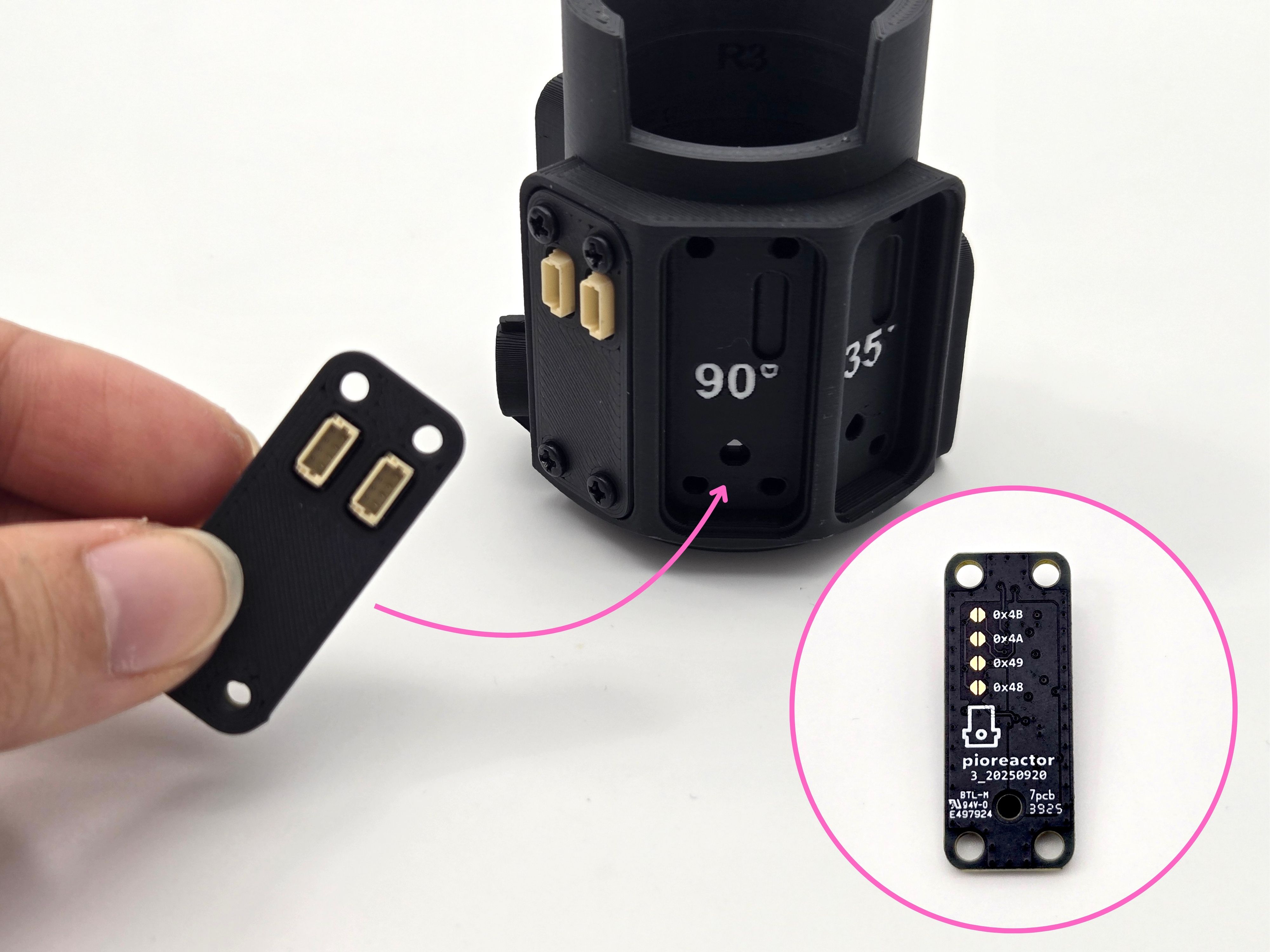

  3. Identify the eye-spy with white mark in the upper left corner. Secure it into the REF pocket with the cover and 4x 8mm screws.
  4. Identify the unmarked eye-spy with no soldered address. Secure it into the 90 degree pocket with the cover and 4x 8mm screws.
  5. Last, the eye-spy with the address 0x48 goes into the 135 degree pocket. Look for the soldered bulb next to the bottom address. Secure it with the cover and 4x 8mm screws.

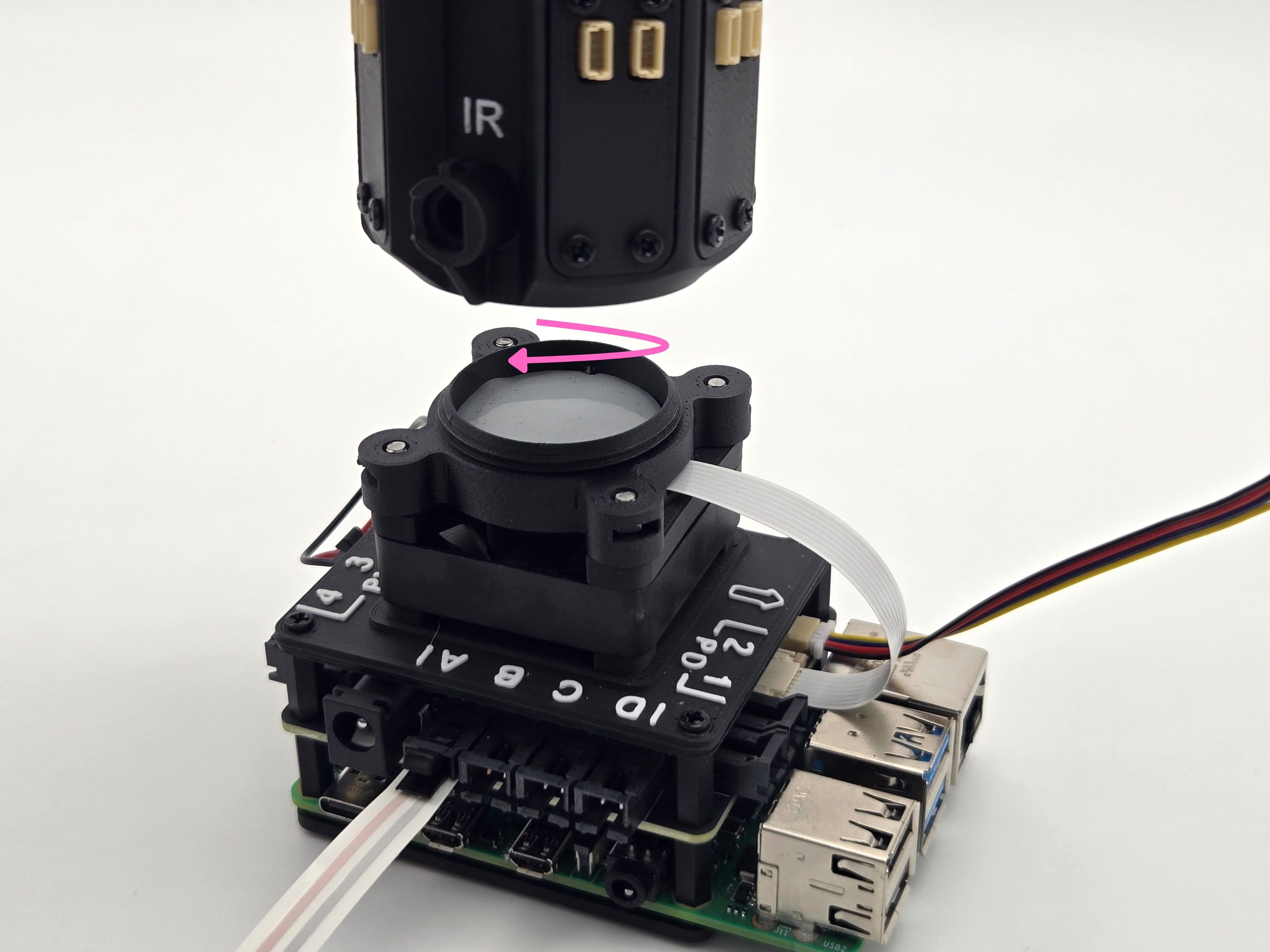

  6. Twist the top vial holder onto the bottom assembly.

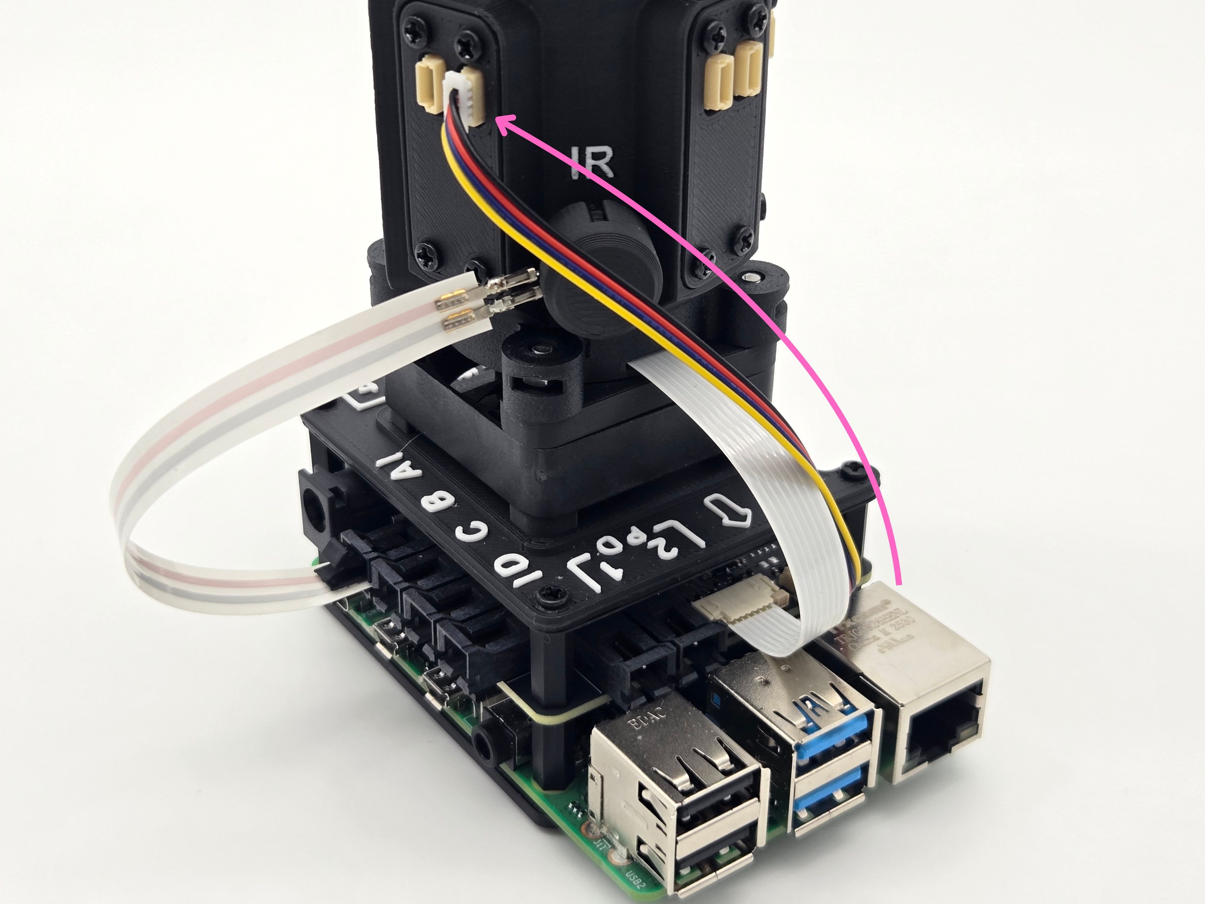

Step 4: Attach the LED bulb #

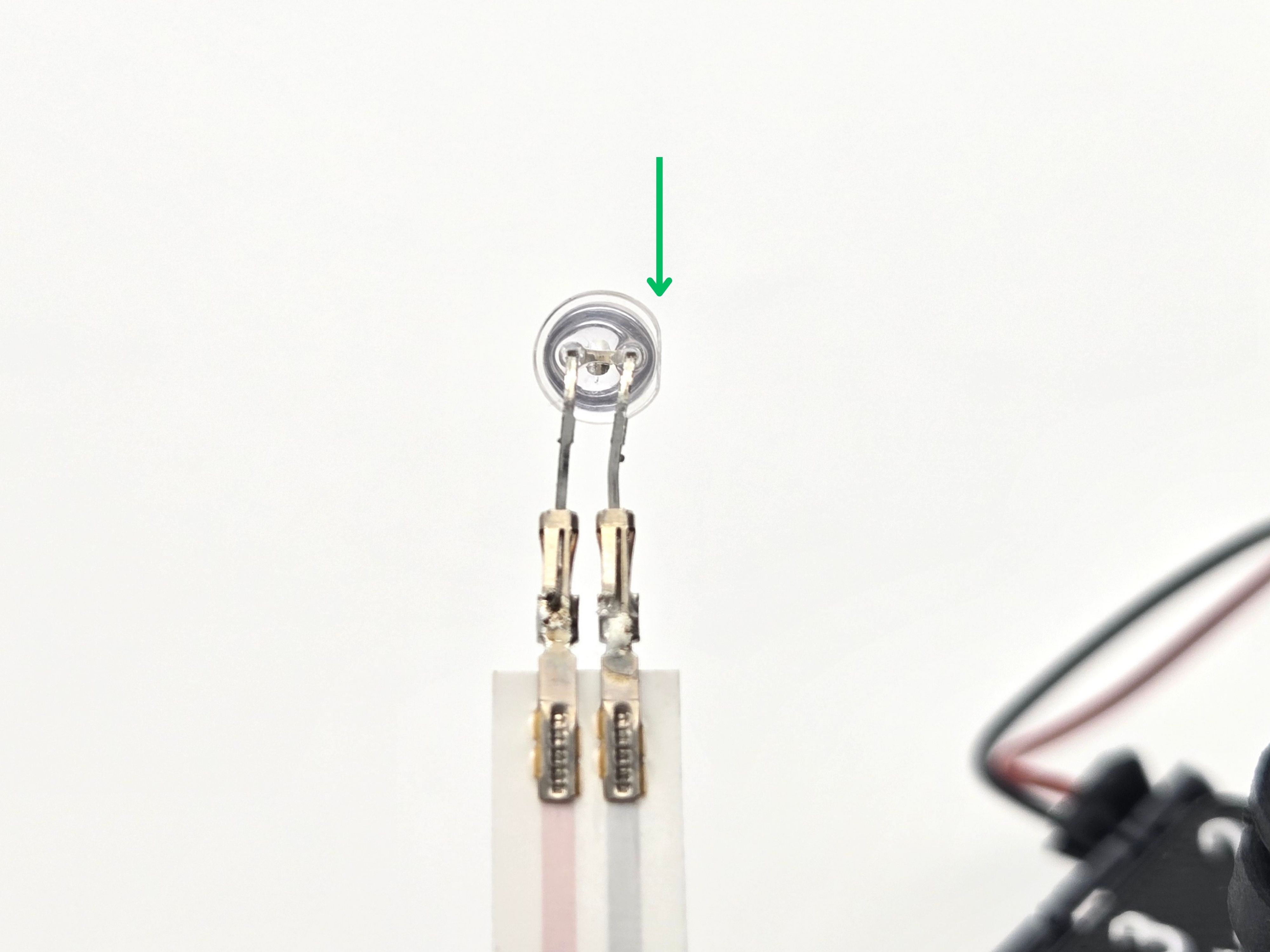

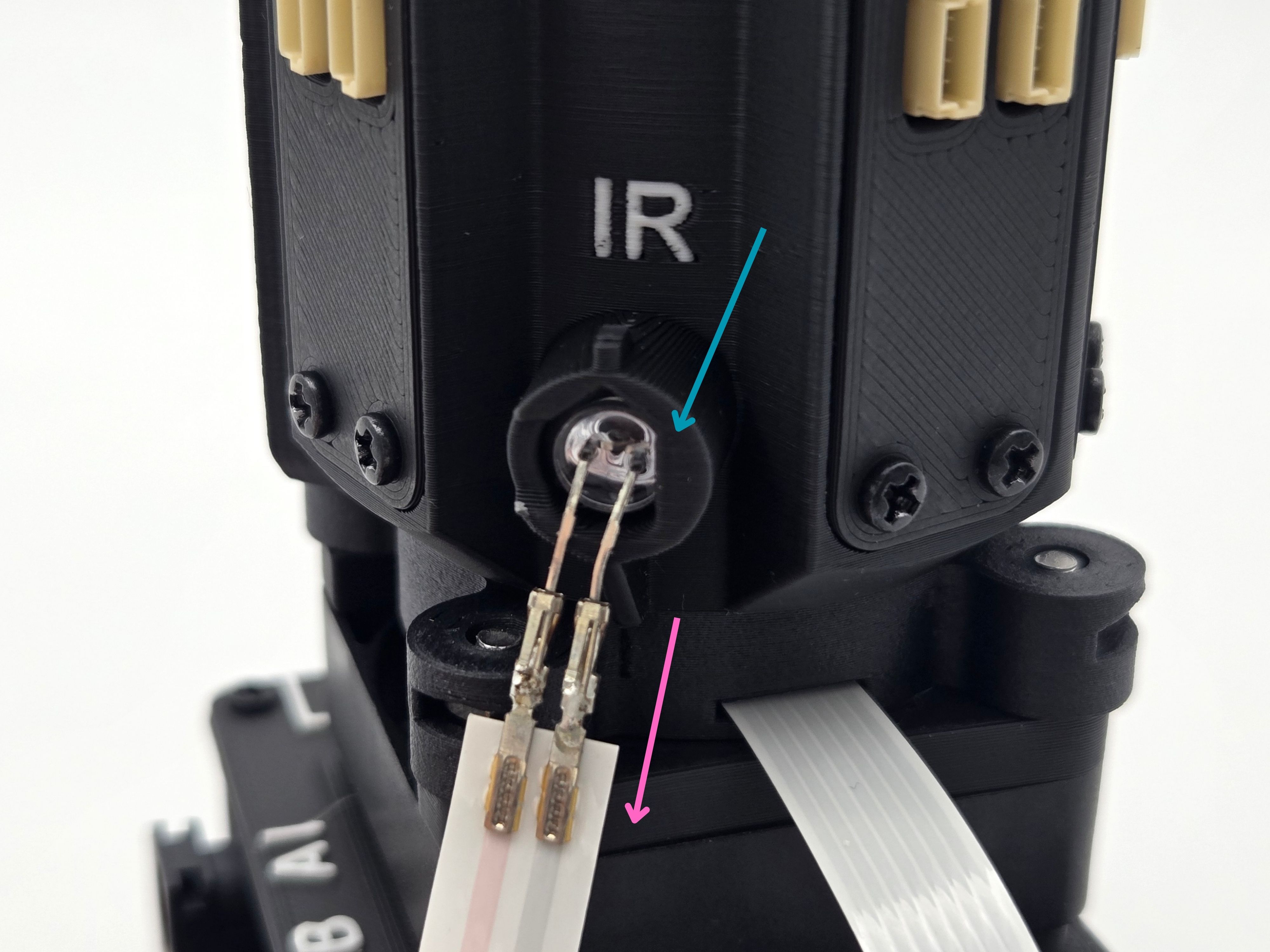

  1. Notice the flat side of the LED bulb.
  2. In the top vial holder, there is a flat protrusion in front of the IR pocket.
  3. With the IR cable pointing downward, gently insert the IR bulb into the pocket.
  4. Gently twist the LED cable to the left. The LED bulb should feel secured in the pocket. Cover it with the LED cap.

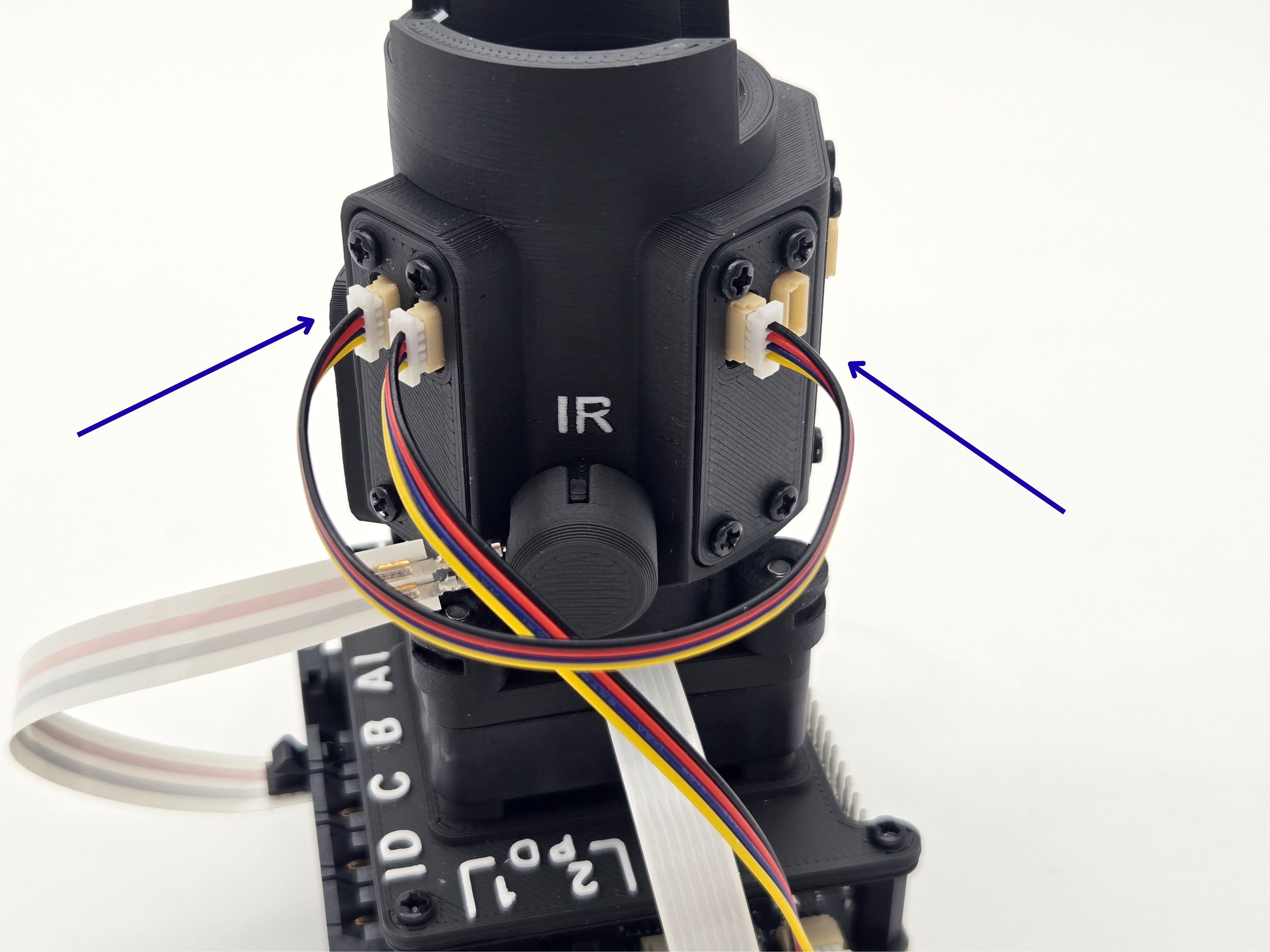

Step 5: Connect the eye-spys #

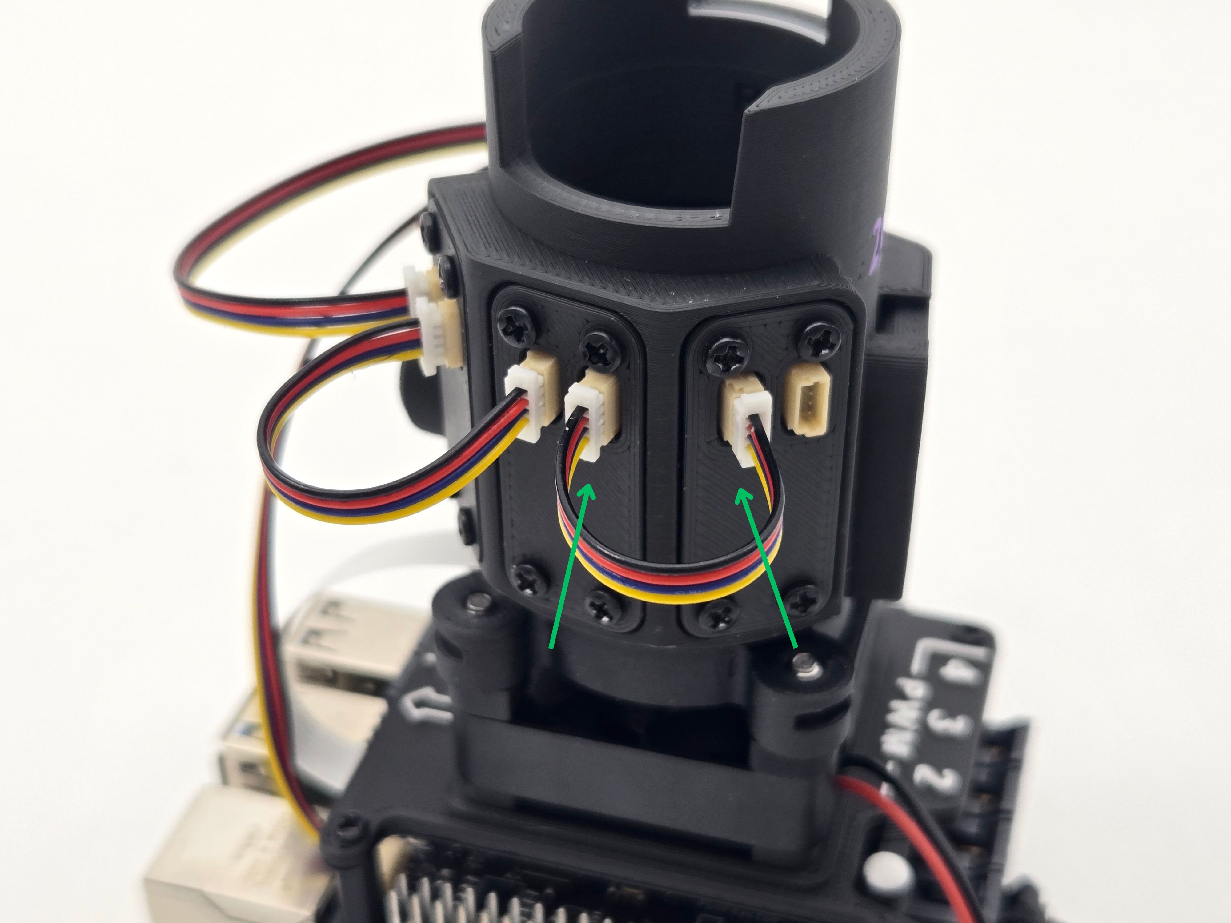

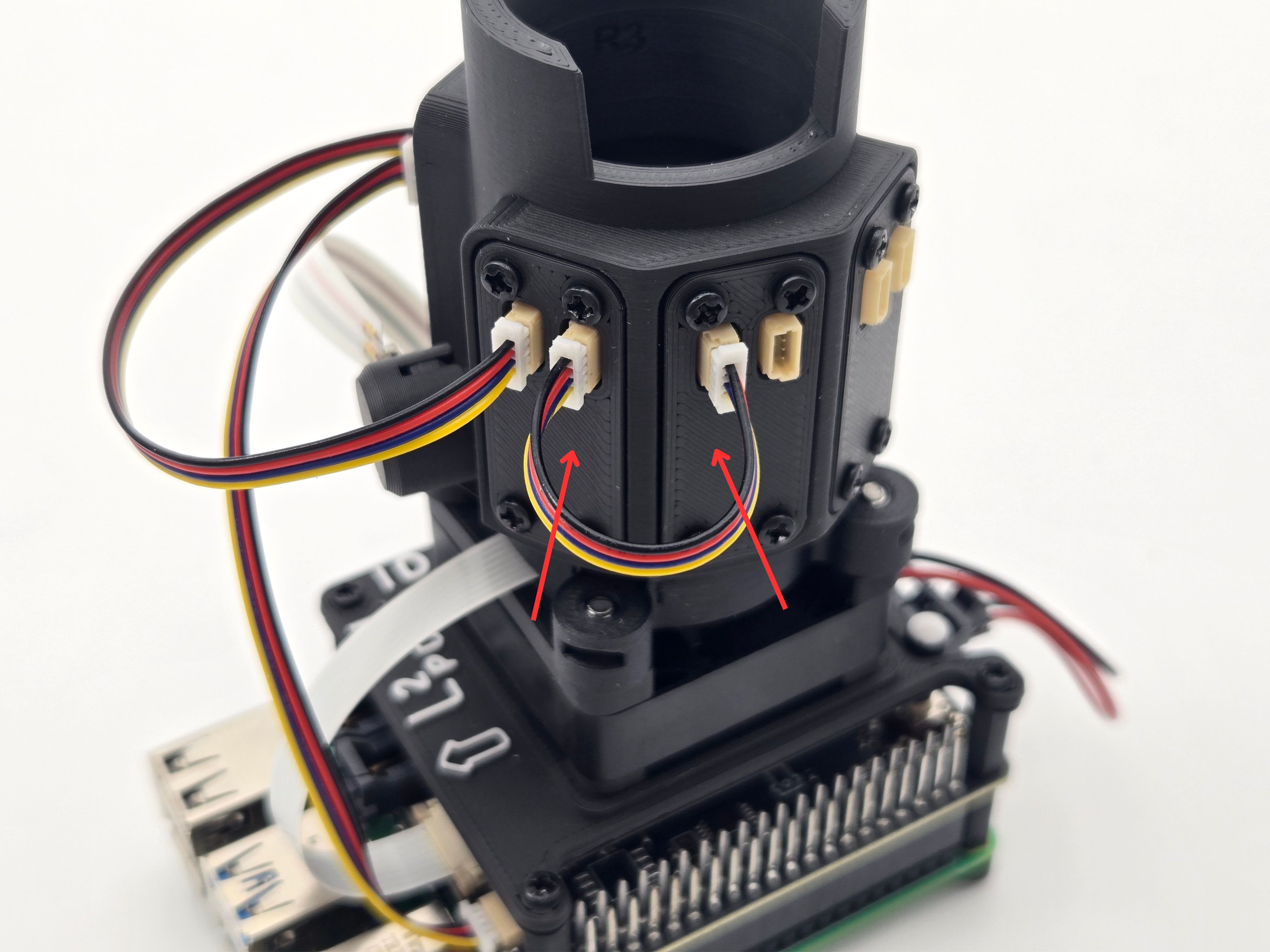

  1. A 100mm STEMMA-QT wire should be still connected to the HAT. Carefully connect the other end to the leftmost, 45 degree eye-spy. Pay attention to the wire orientation: the yellow wire should be at the bottom.
caution
Do not push the wire connector in at an angle, as it can bend the metal leads in the eye-spy connector.
  1. Using the other 100mm STEMMA-QT wire, carefully connect the 45 degree eye-spy to REF. Note the wire orientation.
  2. Use a 50mm STEMMA-QT wire to carefully connect the REF eye-spy to the 90 degree eye-spy.
  3. Finally, use the last 50mm STEMMA-QT to carefully connect the 90 degree eye-spy to the 135 degree eye-spy. All eye-spys should now be daisy chained to each other.

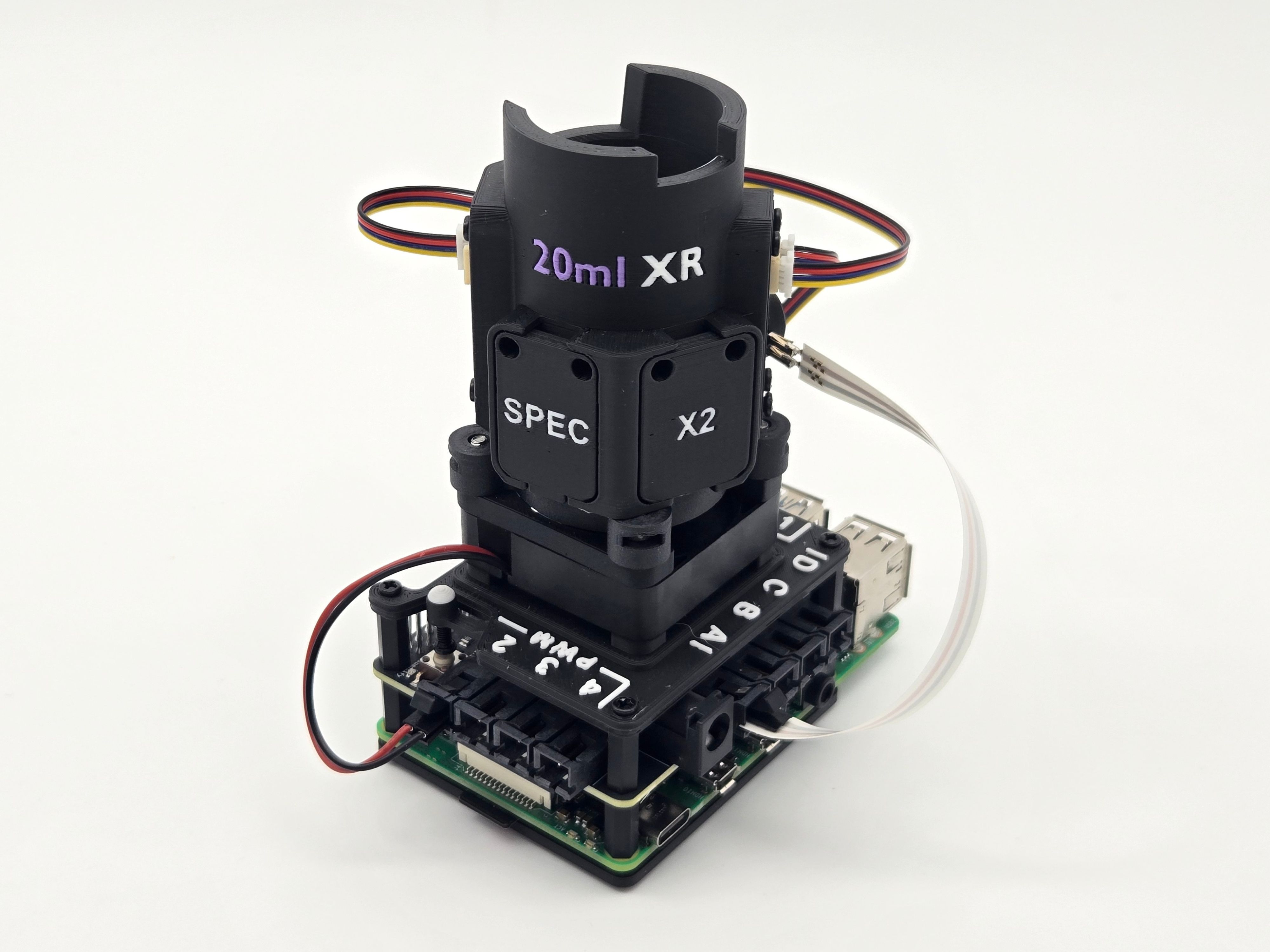

Step 6: XR assmebly completed #
Your new 20ml Pioreactor XR is now assembled!
  1. Power on your Pioreactor again.
  2. Next, we need to adjust some settings in the software.

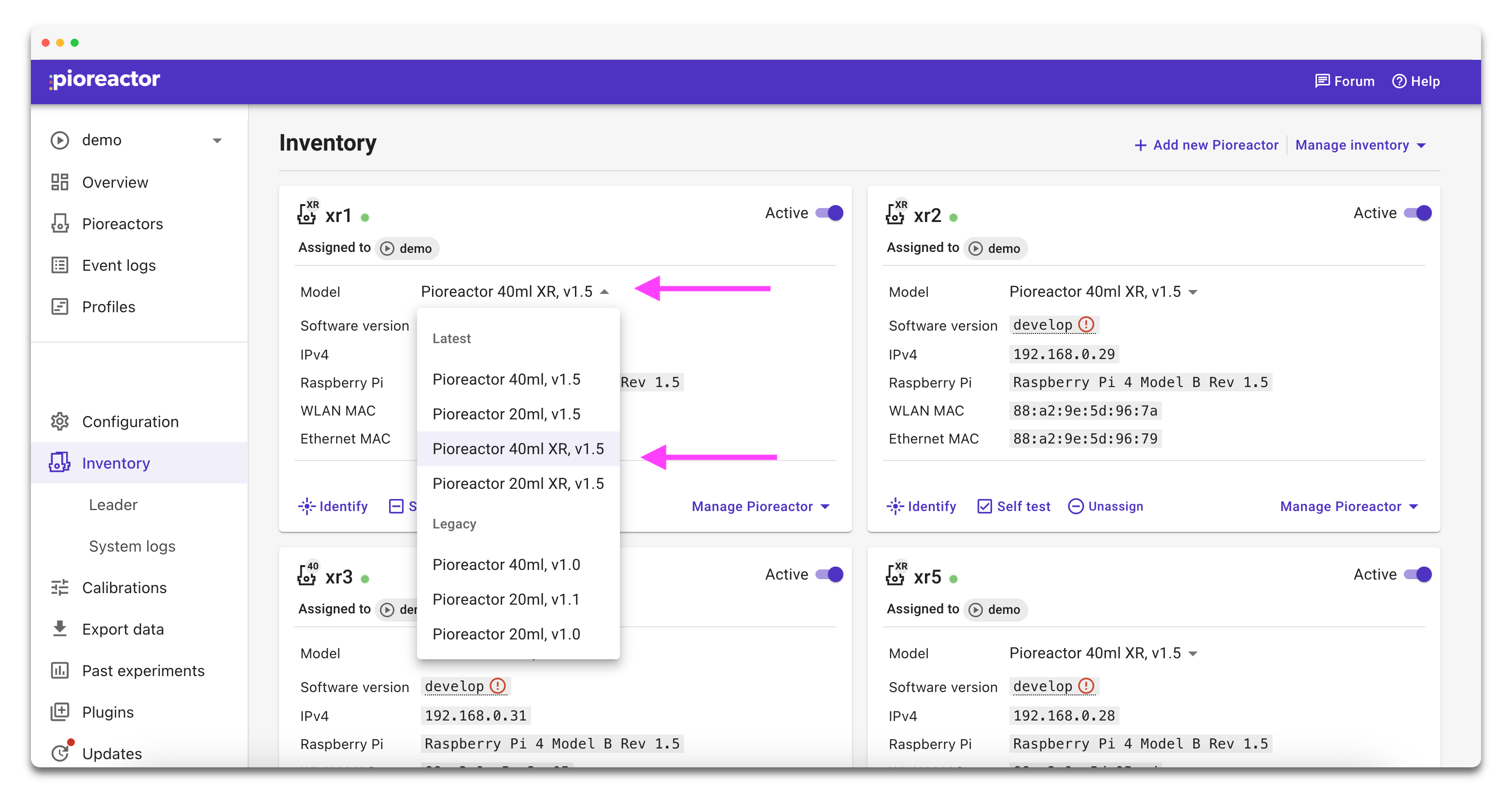

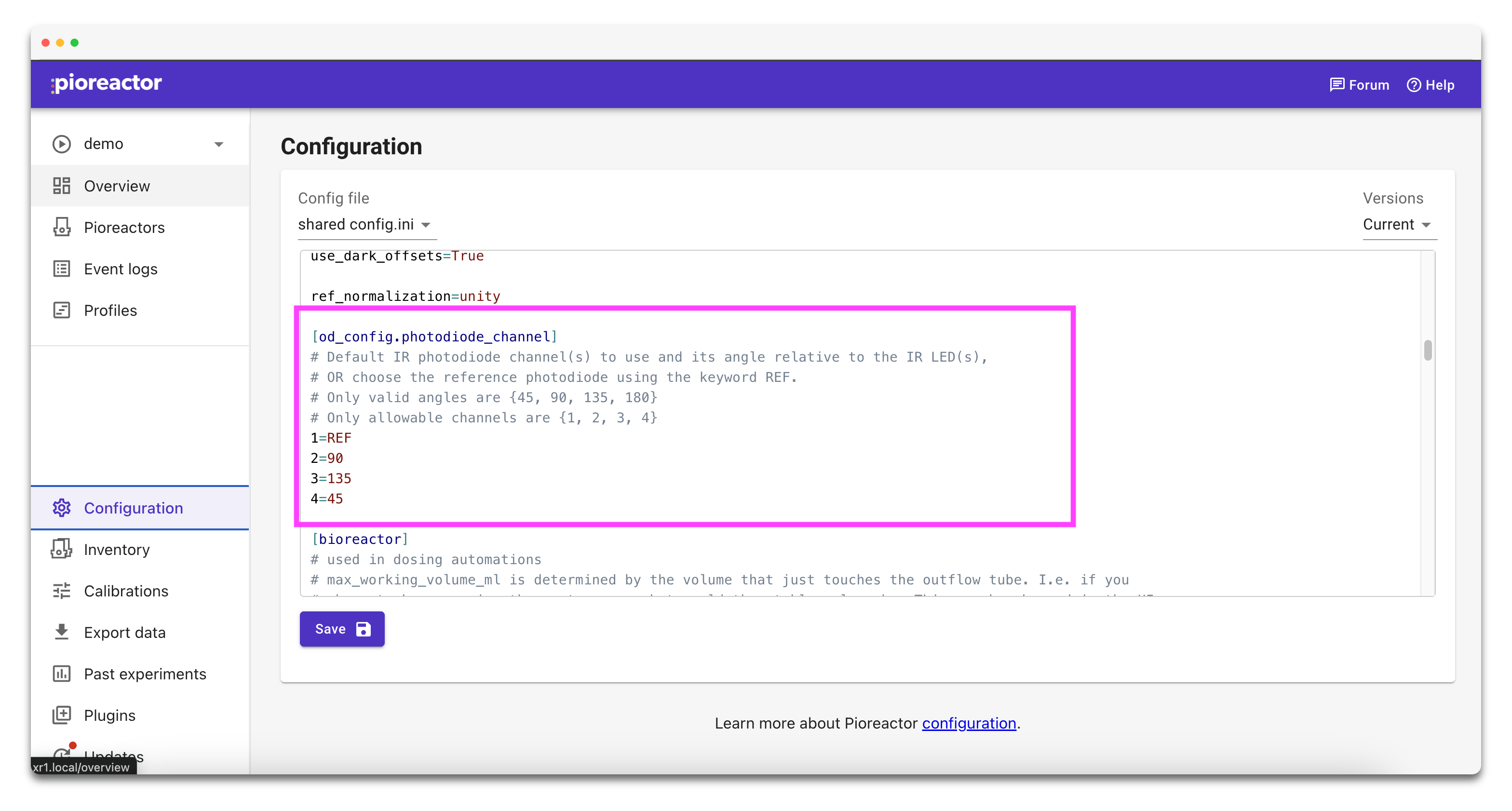

  2. On the Inventory page, find the Pioreactor you upgraded, select Model, and choose the XR version.
  3. On the Edit Config page, add the following to section [od_config.photodiode_channel]
    1=REF
    2=90
    3=135
    4=45
  4. Next, read the docs on how to fuse the sensors into a single biomass signal.
