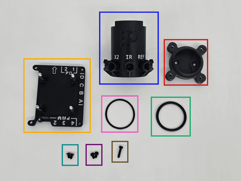

You will need:
  1. The parts provided in your upgrade kit:
  • Top vial holder
  • Bottom vial holder
  • #024 O-ring
  • #121 O-ring
  • Top faceplate
  • Flat headed 5mm screws (2x)
  • M2.5 4mm screws (2x)
  • M2.5 10mm screw (1x)
  1. Your original Pioreactor v1.0, to be upgraded.
  2. A Philip's head screwdriver.

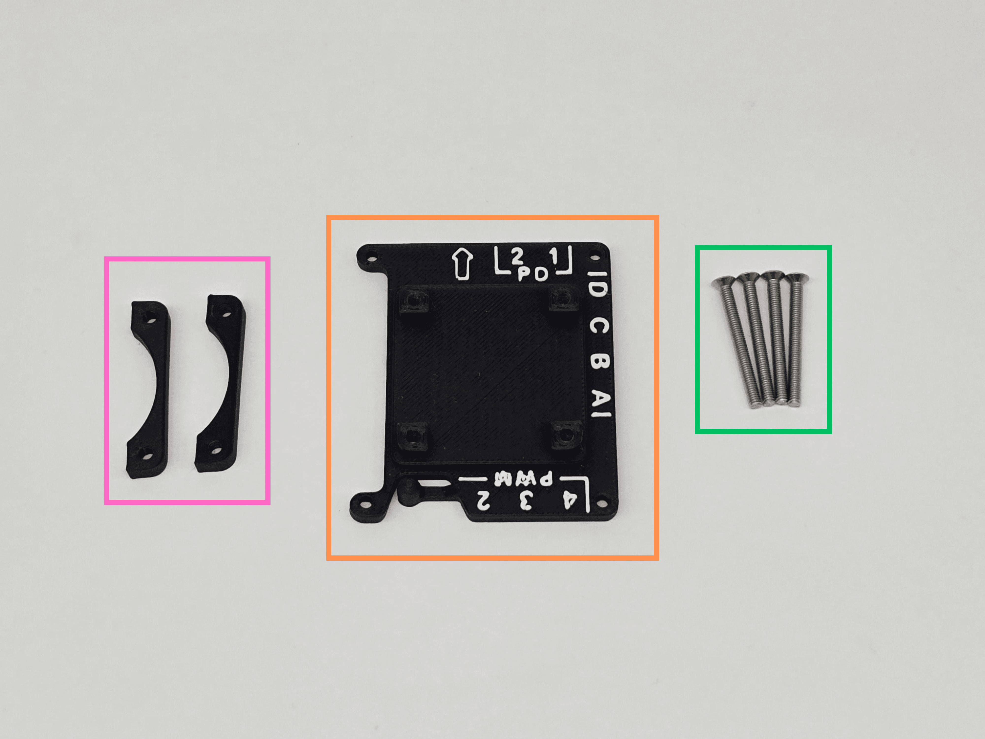

note
Newer versions of the top faceplate will come disassembled, with risers (2x) to secure the fan to the faceplate with 30mm screws (4x). See image 2.
