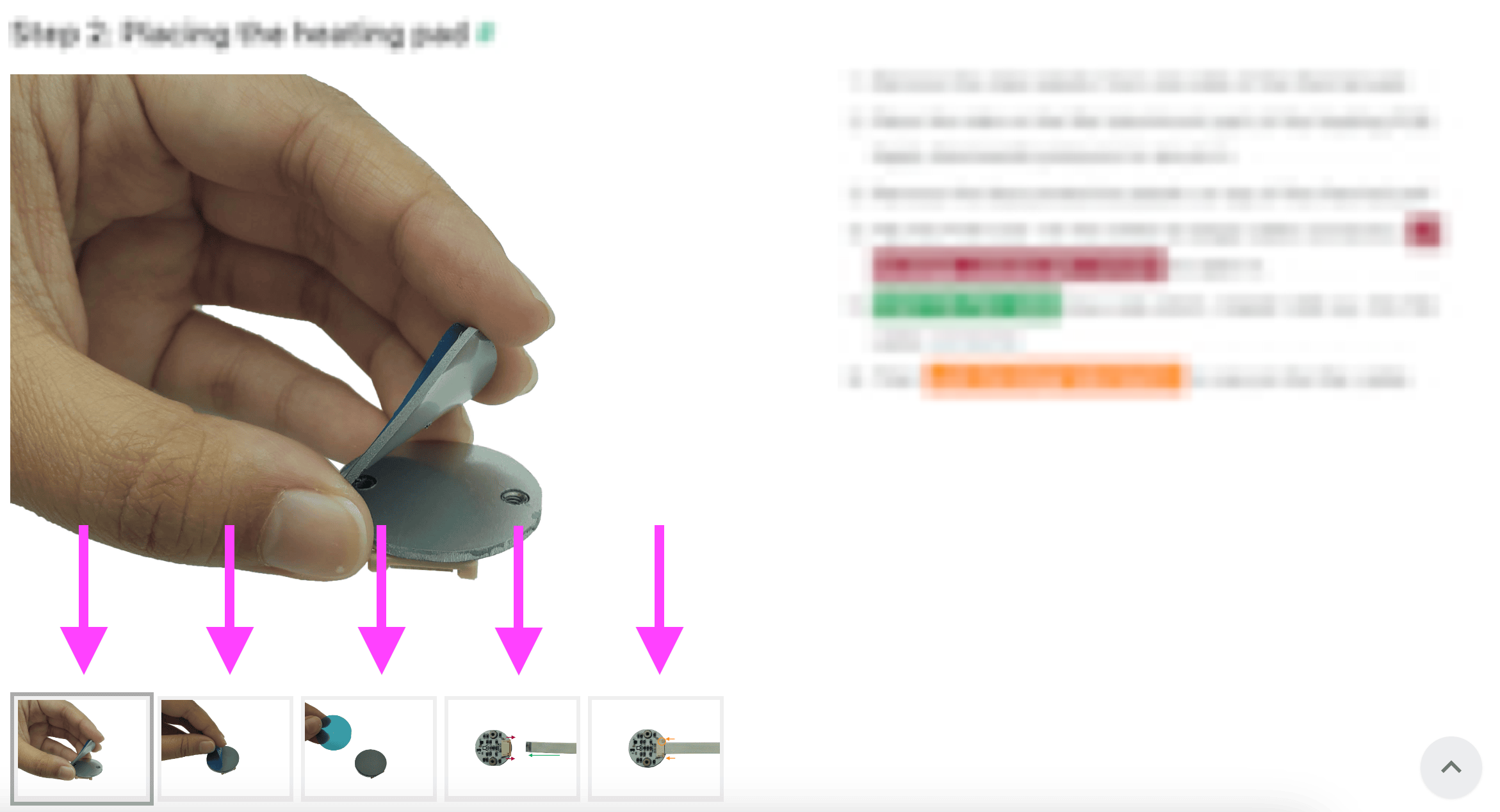

Step 2: Use all the information available to you #
  • Before starting a step, read all instructions and view all photos at the bottom of each step.
  • Most of the labels on the packaging are scaled 1:1 and can be used to identify parts.
