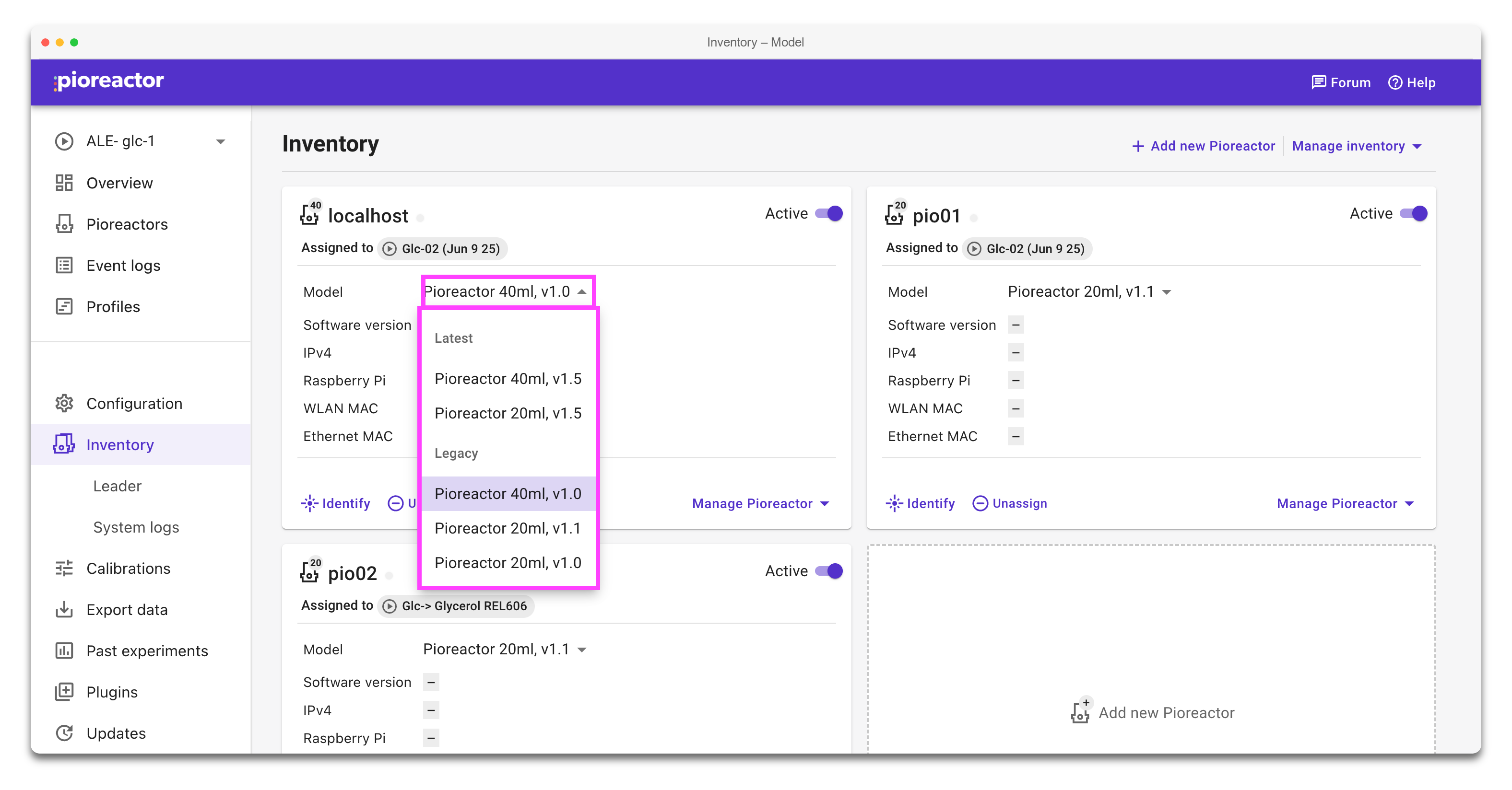

Update a Pioreactor's model from the UI
You can update the model that the software uses for each unit from the Inventory page.
- Navigate to Inventory in the sidebar.
- Locate the Pioreactor you want to configure and open the Model dropdown.
- Pick the correct entry. The change is saved immediately.
Changes to the model update any UI text, configuration safety limits, and workflows that depend on vessel geometry.
