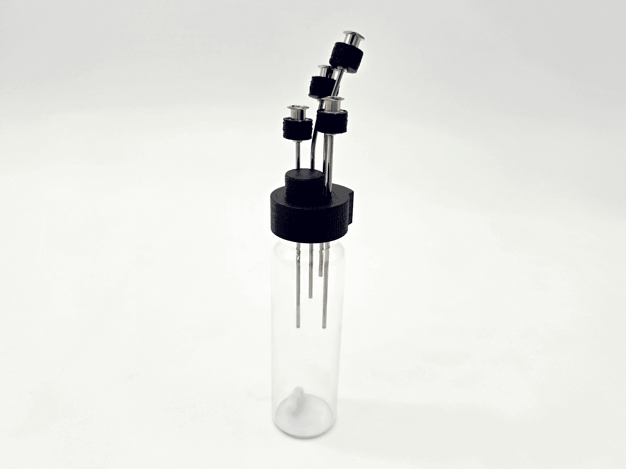

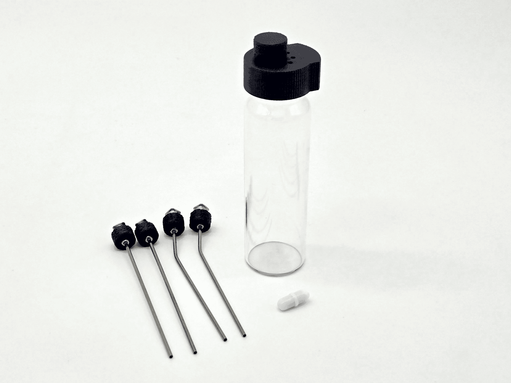

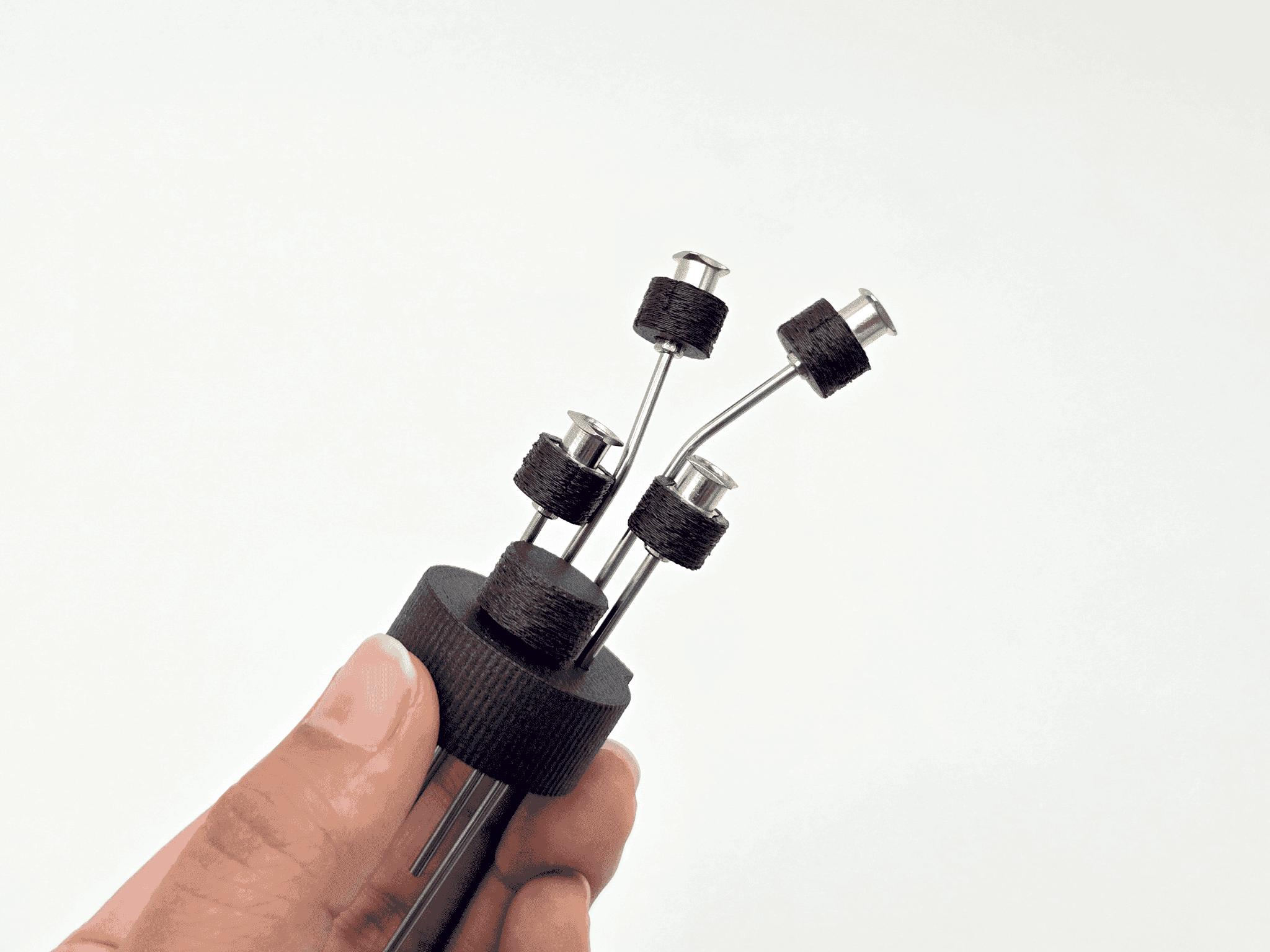

  1. Gather the 40ml vial, stirbar, and stainless steel ports.
  2. Remove the cap from the vial.

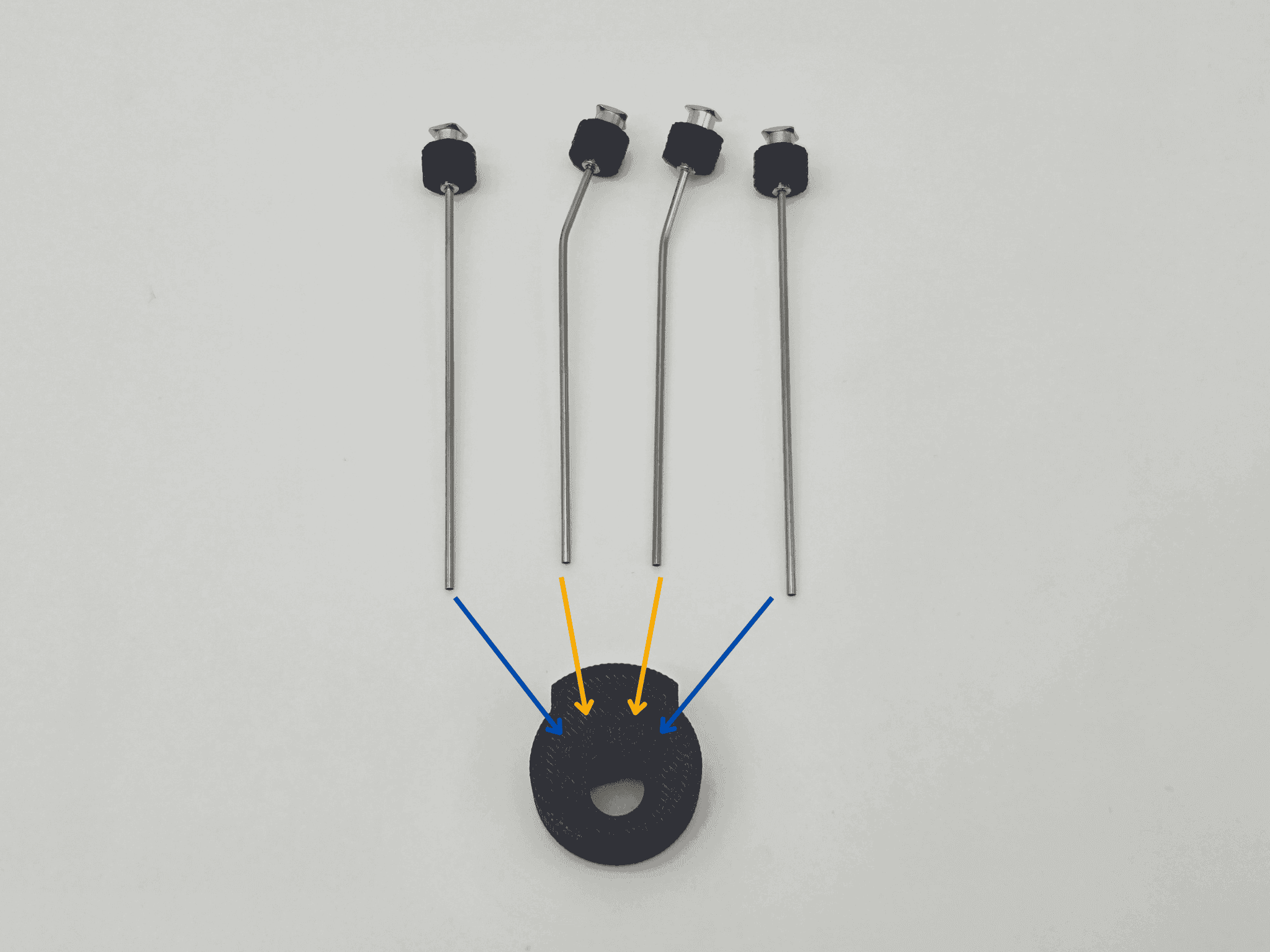

  3. Gently but firmly push the stainless steel ports into the four holes. The two straight ports are placed in the outer holes, and the two bent ports are placed in the inner holes. If you have the plastic ends, the green colored one goes into the hole labelled E.
  4. Place the stirbar in the vial and secure the cap.

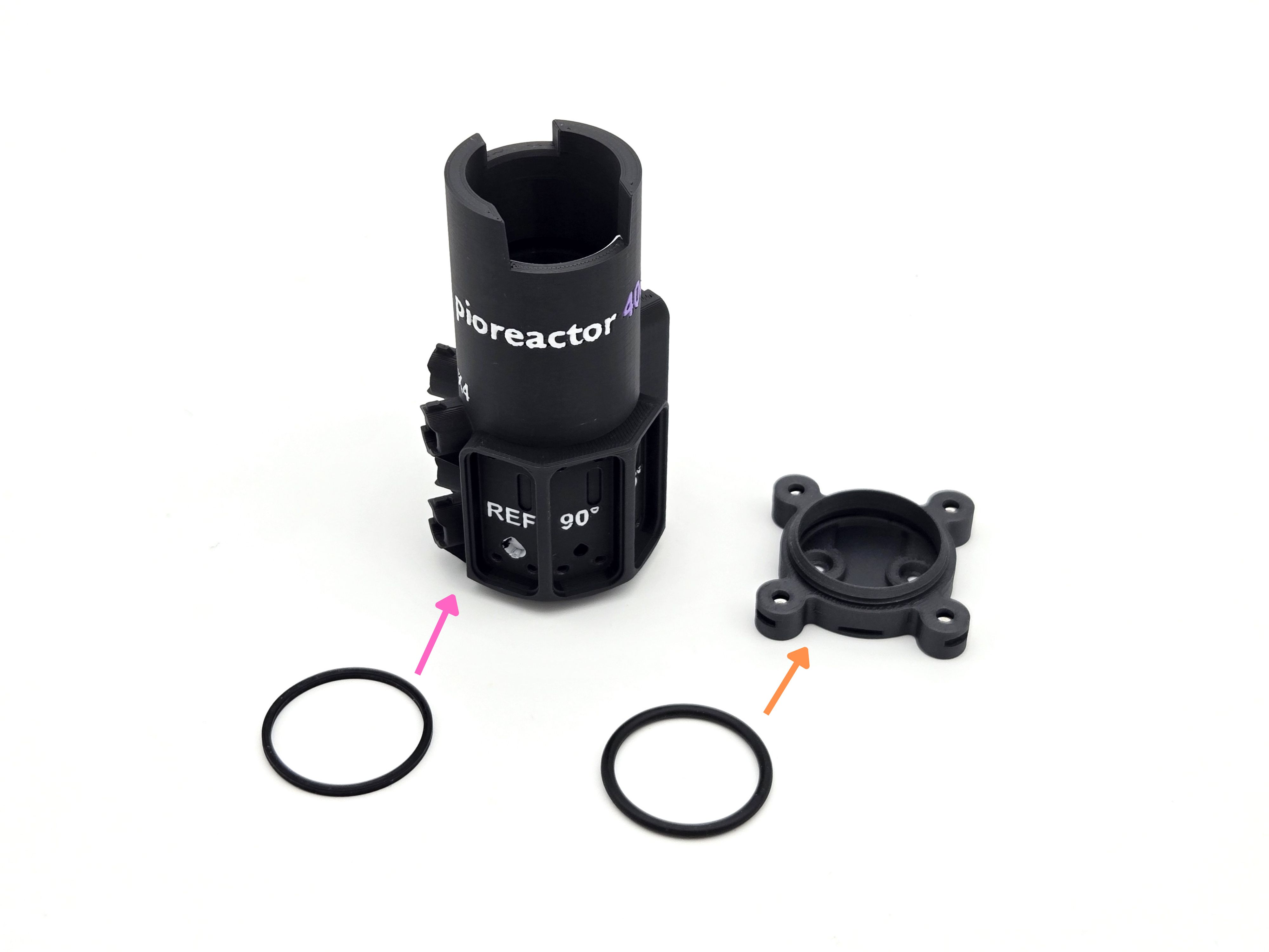

Step 2: Inserting the O-rings #
note

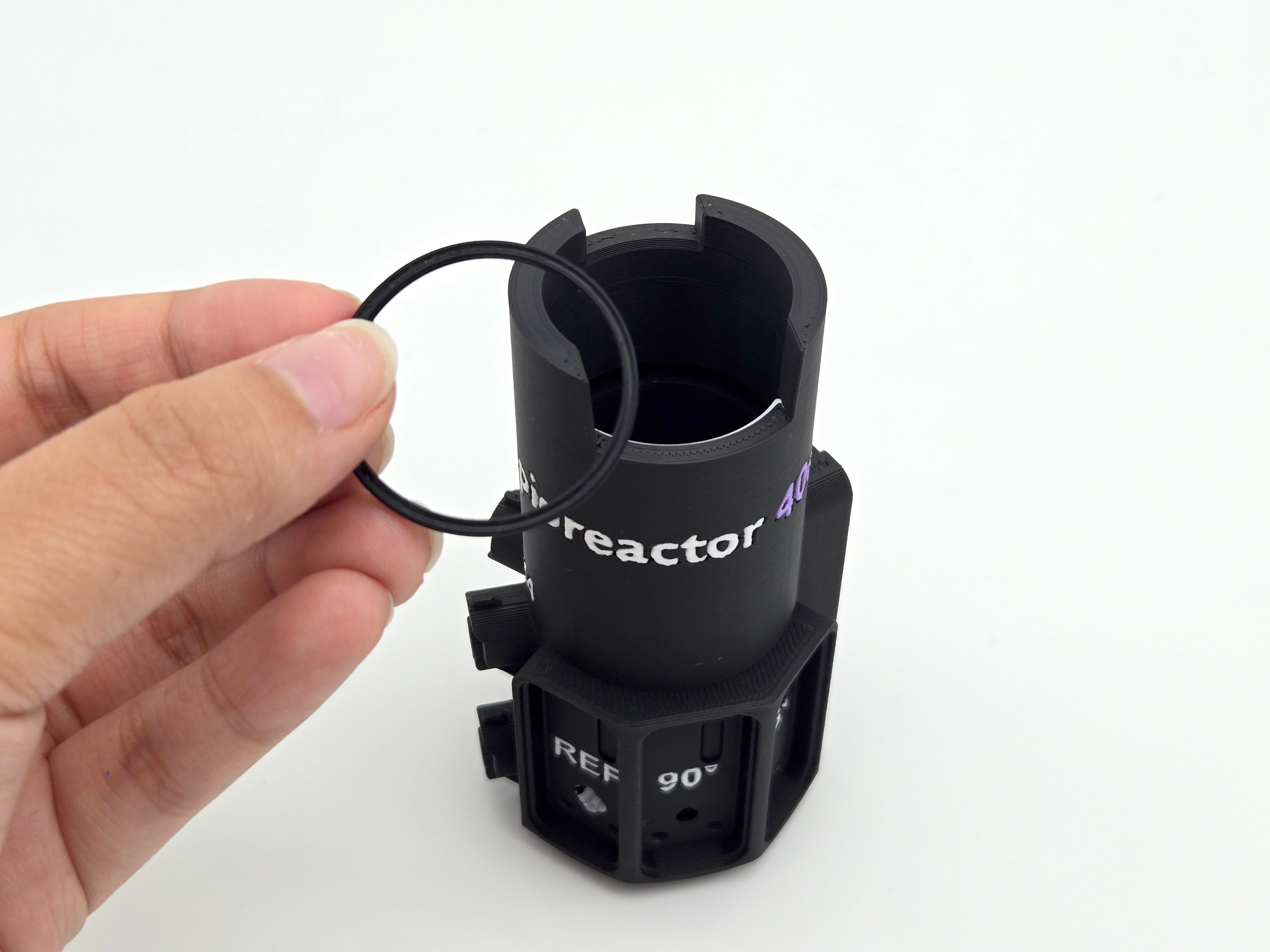

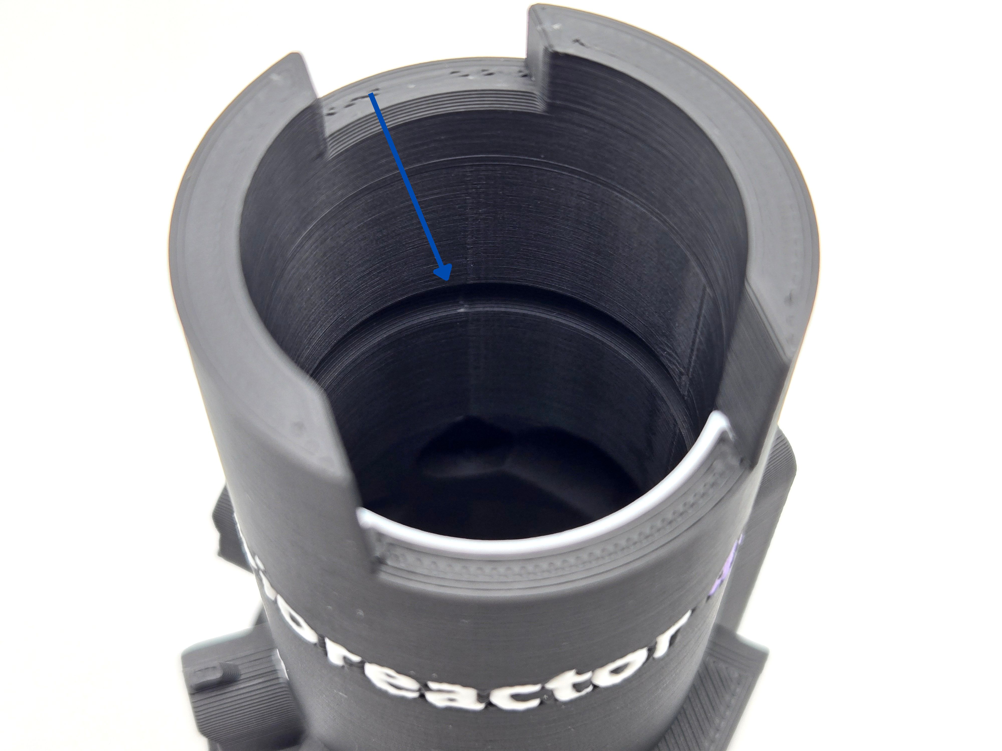

The vial holder comes in two halves; a top vial holder and a bottom vial holder. Both have sections to insert O-rings for a more secure hold on your vials and increased protection against leaks. The thinner O-ring (#024) with an X-shaped cross section fits into the top piece. The thicker O-ring (#121) lines the bottom piece.
  1. The O-rings are pre-lubricated with a silicone-based lubricant. If needed, remove any excess lubricant from the O-rings.
  2. The top vial holder has a groove within the body where the thinner #024 O-ring sits. Carefully insert the O-ring using your fingers. Make sure to not twist the O-ring.
  3. Run your finger inside the vial holder, pushing the O-ring into place to ensure a snug fit.
  4. The bottom vial holder has a groove for the thicker #121 O-ring. The O-ring will sit between the base of the holder and the heater PCB. Carefully insert the O-ring using your fingers. Make sure to not twist the O-ring.
  5. Push the O-ring into place to ensure a snug fit.

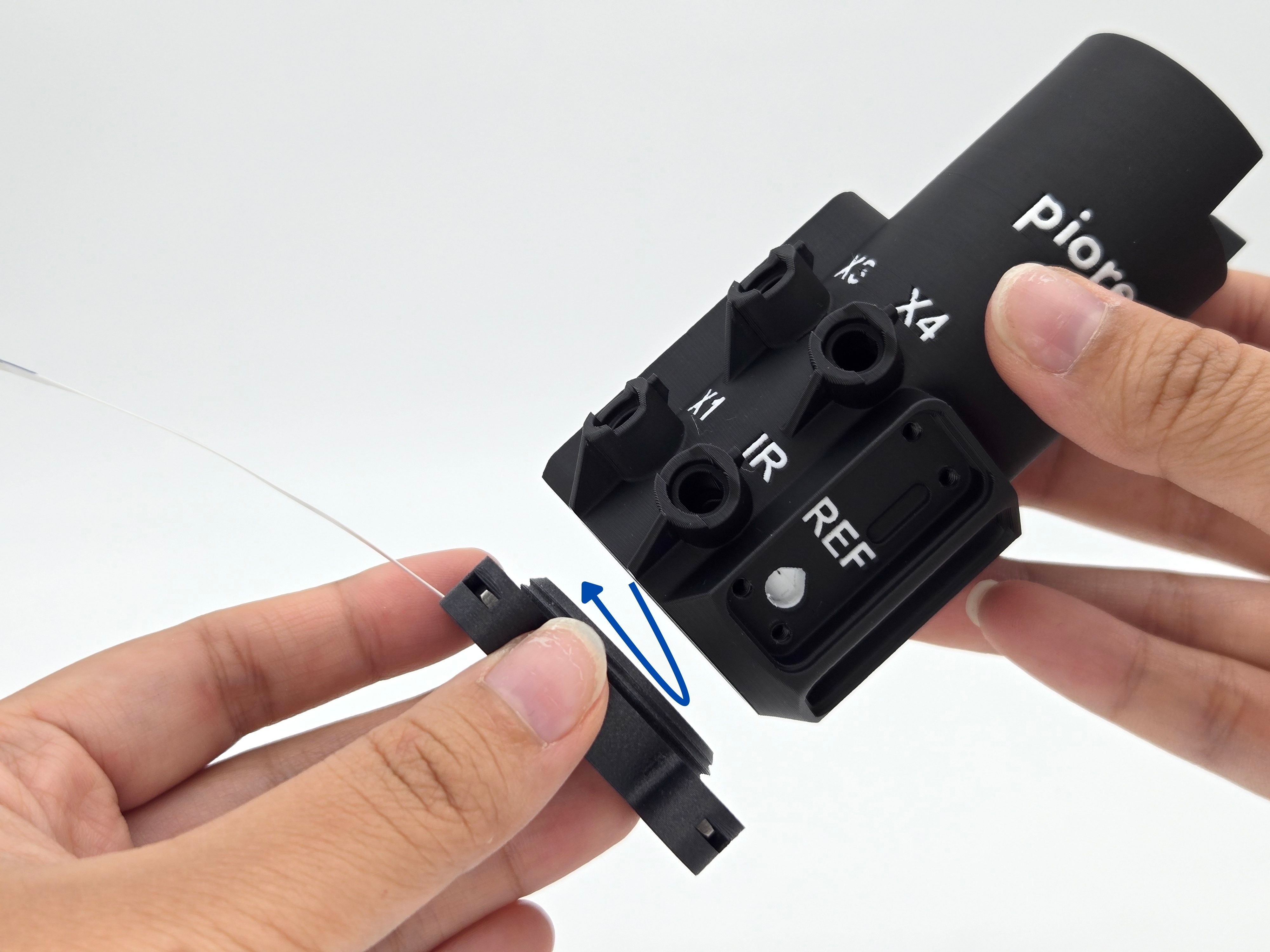

Step 3: Connect the flex cable #
  1. On the heater PCB, locate the white-&-beige cable connector, pull the beige-colored tabs outward to open it.
  2. Insert the flex cable blue side down, copper side up, into the cable connector.
  3. Then push the beige tabs back in to secure the flex cable.
Step 4: Place and secure the heater PCB #
  1. Insert the other end of the flex cable below the O-ring and into the groove. Pull it through.
  2. Apply pressure on the back of the heater PCB so that it lies flat on the O-ring. Maintain this pressure for the next steps.
  3. While maintaining pressure, flip the holder and insert the two brass M2.5-CS 4mm screws - don't tighten fully yet.
  4. While maintaining pressure, take turns screwing each in until both are reasonably tight, and the heater PCB is securely attached to the bottom vial holder.

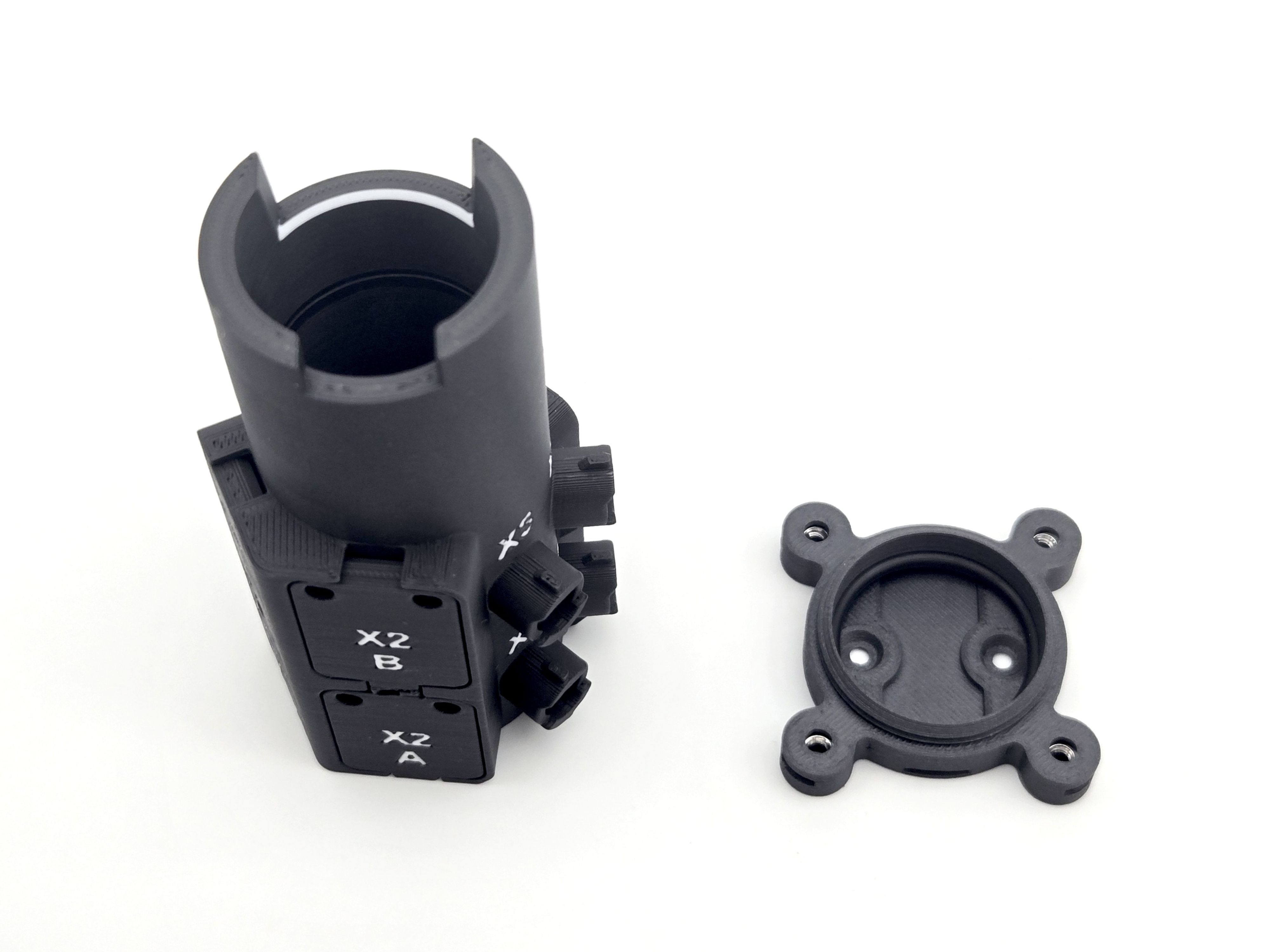

Step 6: Complete the vial holder #
  1. Screw the top and bottom vial holder sections together so that the IR label is positioned above the flat-flex-cable.
  2. Set this aside and proceed to the next page.
