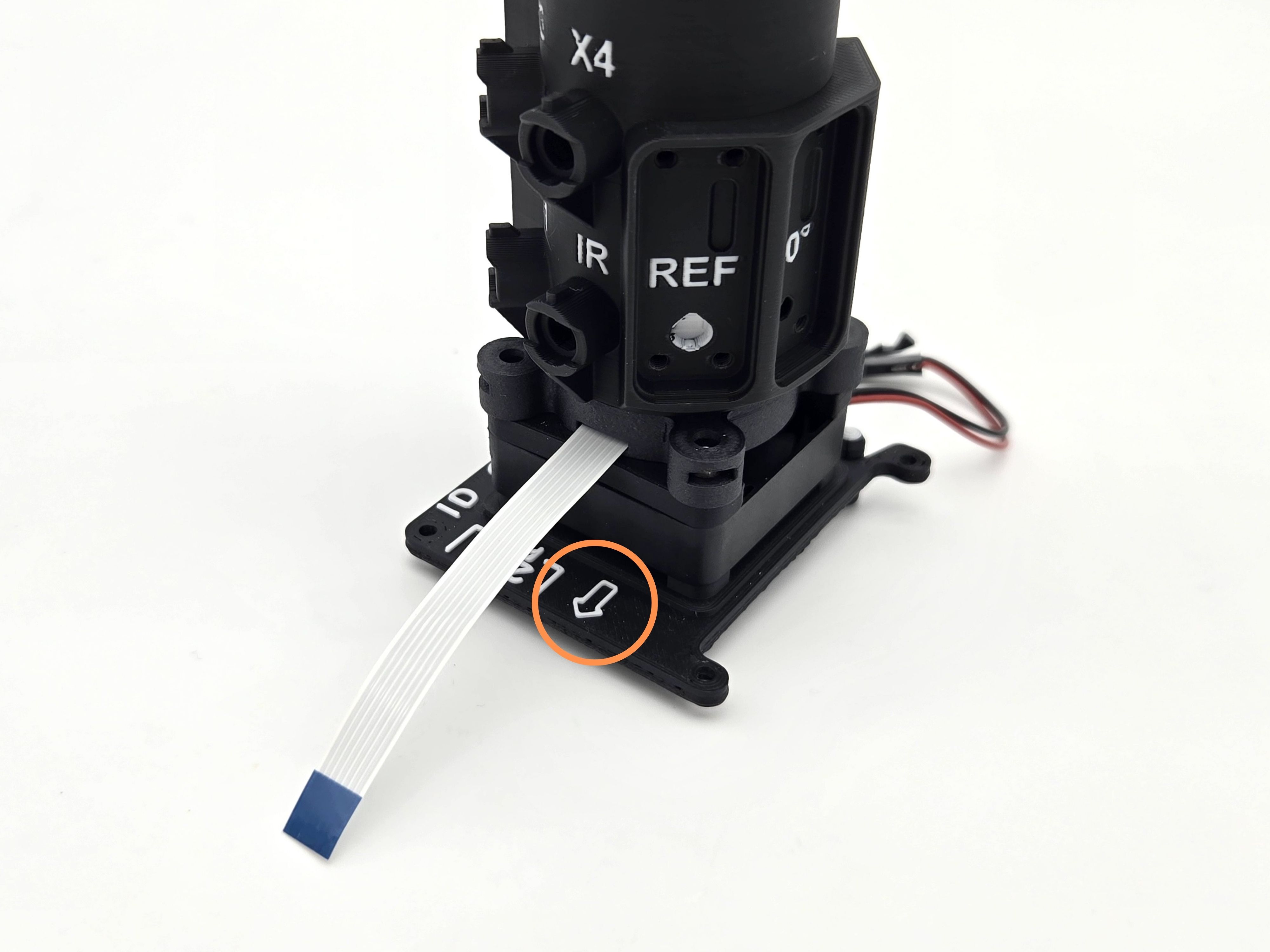

  1. Place the vial holder on top of the four ends of the 30mm screws. The screw ends should fit into four holes on the bottom of the vial holder. The flat flex cable should follow the arrow on the faceplate.
  2. Holding it together, finish screwing the M3 30mm screws on the bottom of the faceplate. The screws will enter square nuts in the vial holder. Do not overtighten.
    caution
    You should not feel resistance when tightening the screws into the square nuts. If you encounter resistance, unscrew partially and inspect the end of the screw for any plastic debris.
  3. The screw heads will be flush with the faceplate, and there should be no screw threads showing between the vial holder and the faceplate.

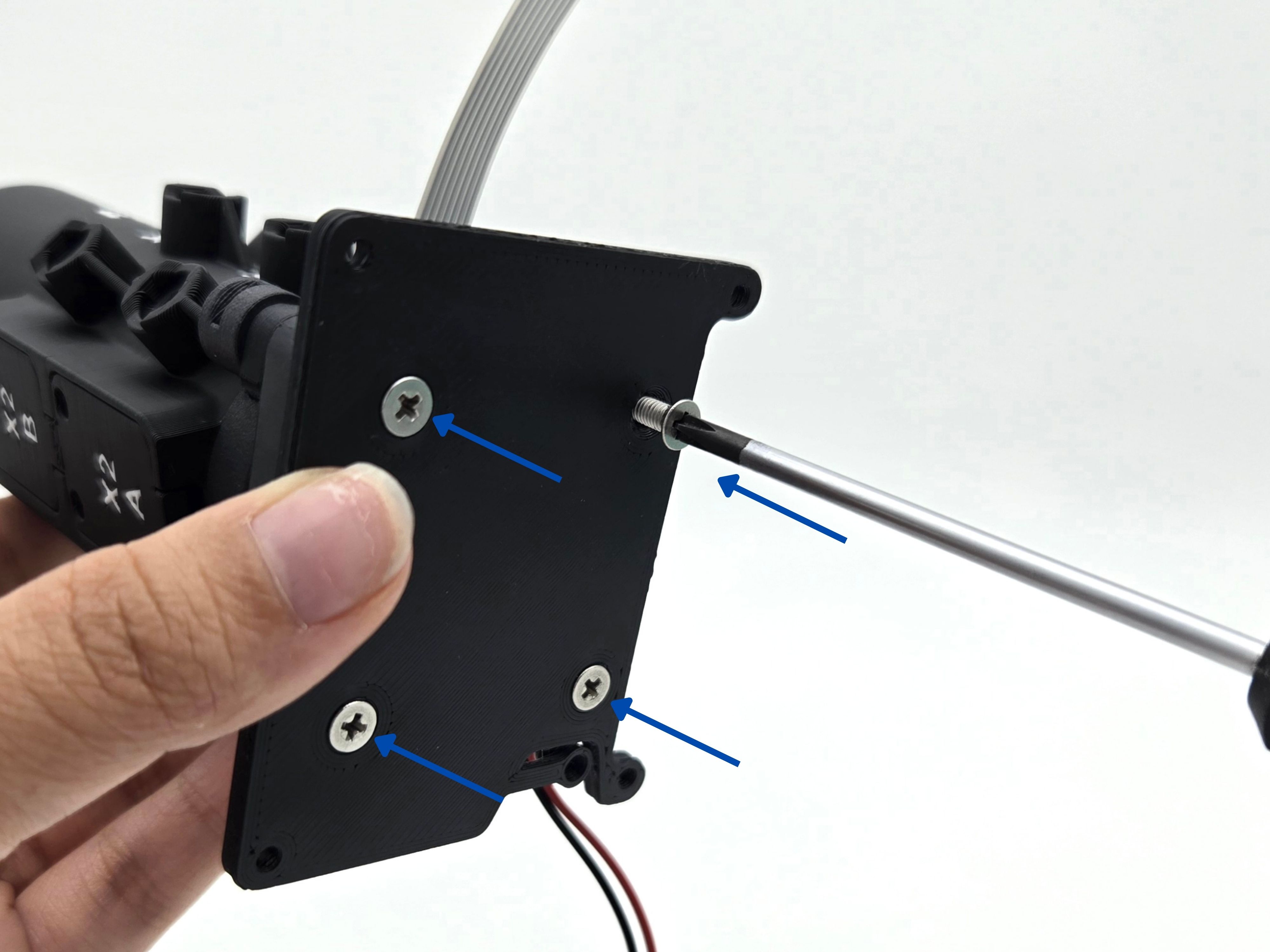

Step 3: Button extension #
The top faceplate comes with a button extension to provide easier access to pushing the button.
  1. Flip over the assembly.
  2. Insert the 8mm screw into the hole under the button extension.
  3. Place one finger behind the extension and rotate with the other hand until the screw is secure in the hole. Don't over-tighten! Once established, you can use a screwdriver to finish screwing it in until you feel sufficient resistance. Don't over-tighten!

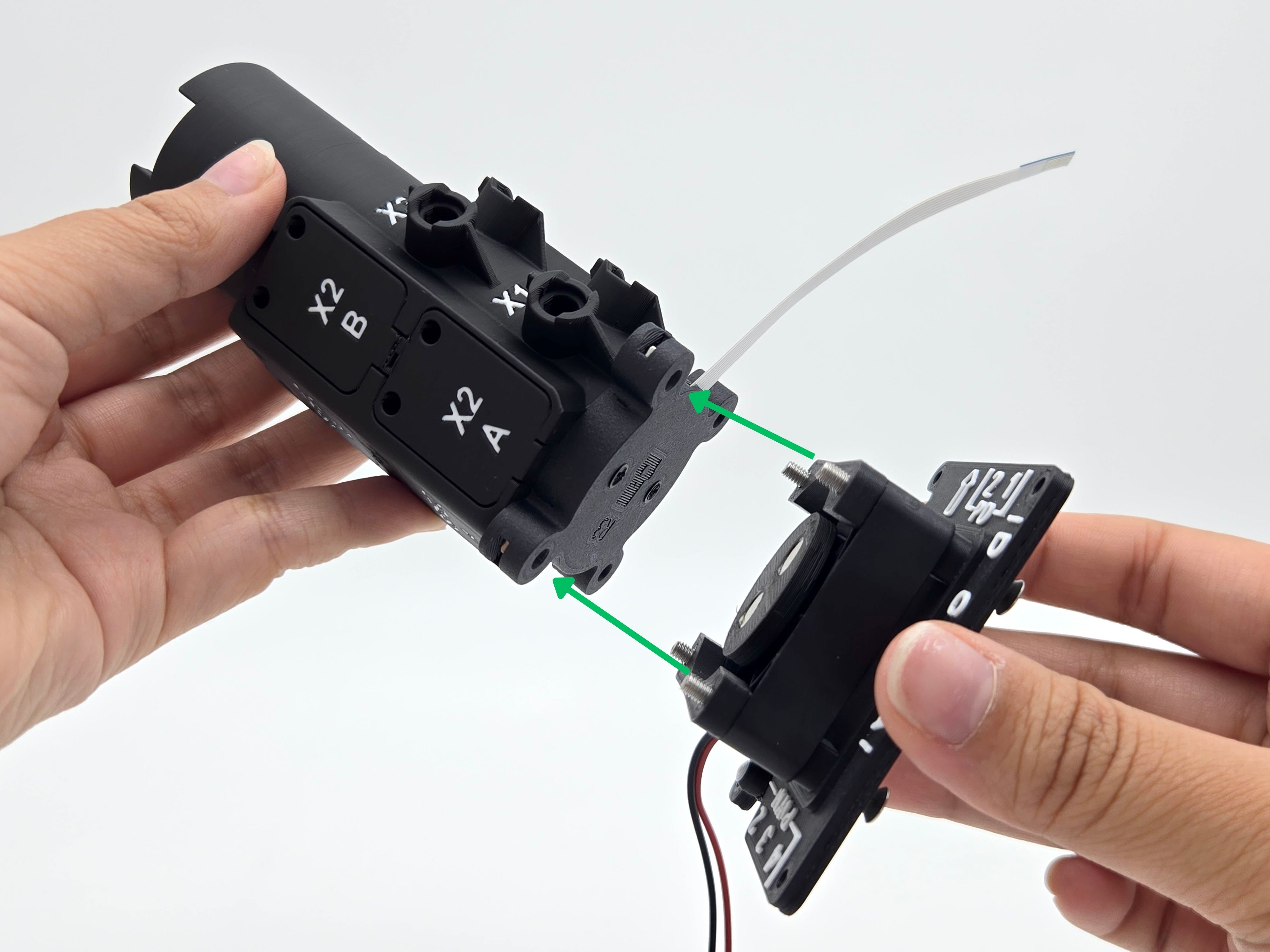

Step 4: Putting it all together #
  1. Place the vial holder assembly onto the Raspberry Pi/HAT's corners. The GPIO pins align with the side notch of the faceplate.
  2. Using 4x of the M2.5 8mm screws, attach the top and bottom pieces in each corner.
info
Older kits may contain 4x M2.5 6mm screws instead. Use theses instead. Double check using the sticker guide on the bag containing the fasteners.
  1. Check that the screw for the button extension is in the right position and not prematurely compressing the button under it (you should feel a "click" when pressing the button extension). Remove the top and screw in the M2.5 8mm screw more if you detect a problem.
  2. Open the flat flex cable connector on the HAT by pulling the tabs outward, like done previously. Insert the flex cable copper-side up.
  3. Push the tabs inward to secure the flex cable.
  4. Insert the stirring power connector into PWM channel 1 (unlabelled).
