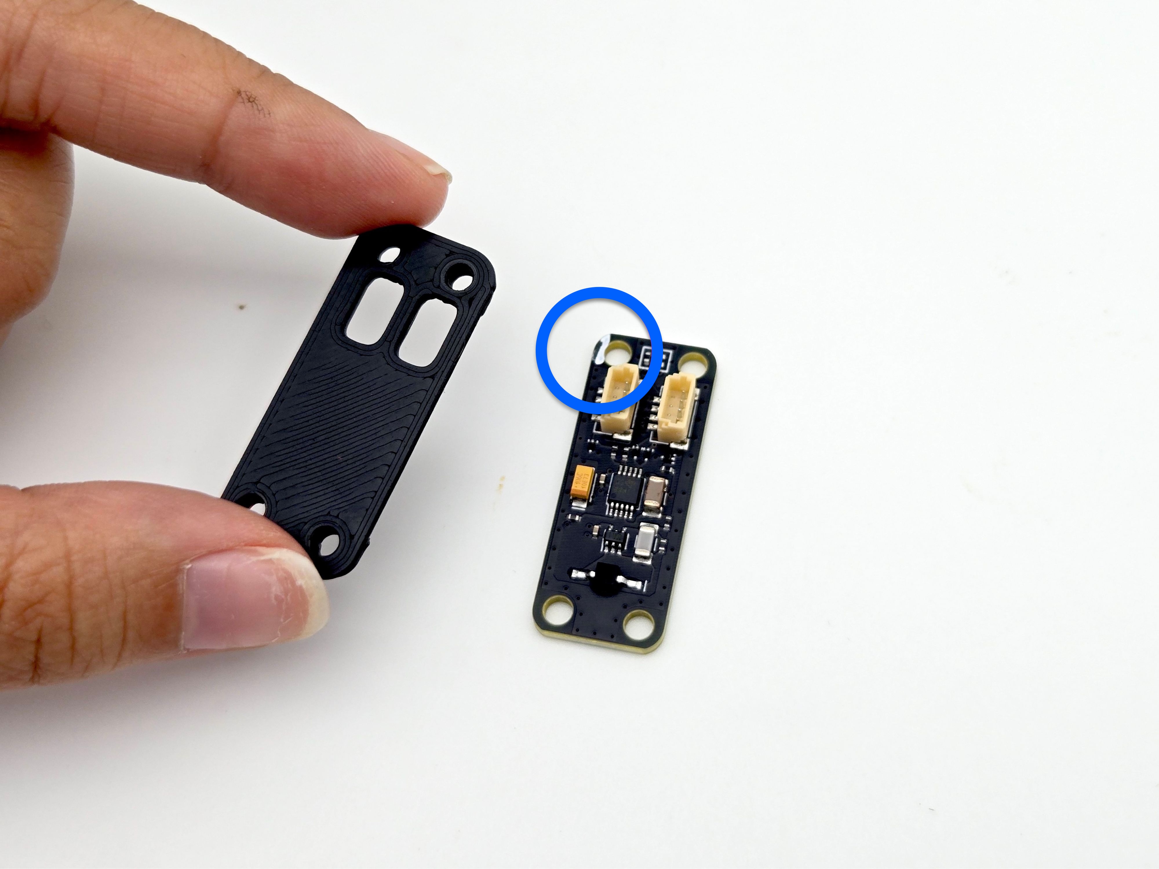

  1. Place an eye-spy cover over the REF eye-spy.
tip
Each eye-spy is unique. The one used for REF has a white mark in the upper-left corner.
