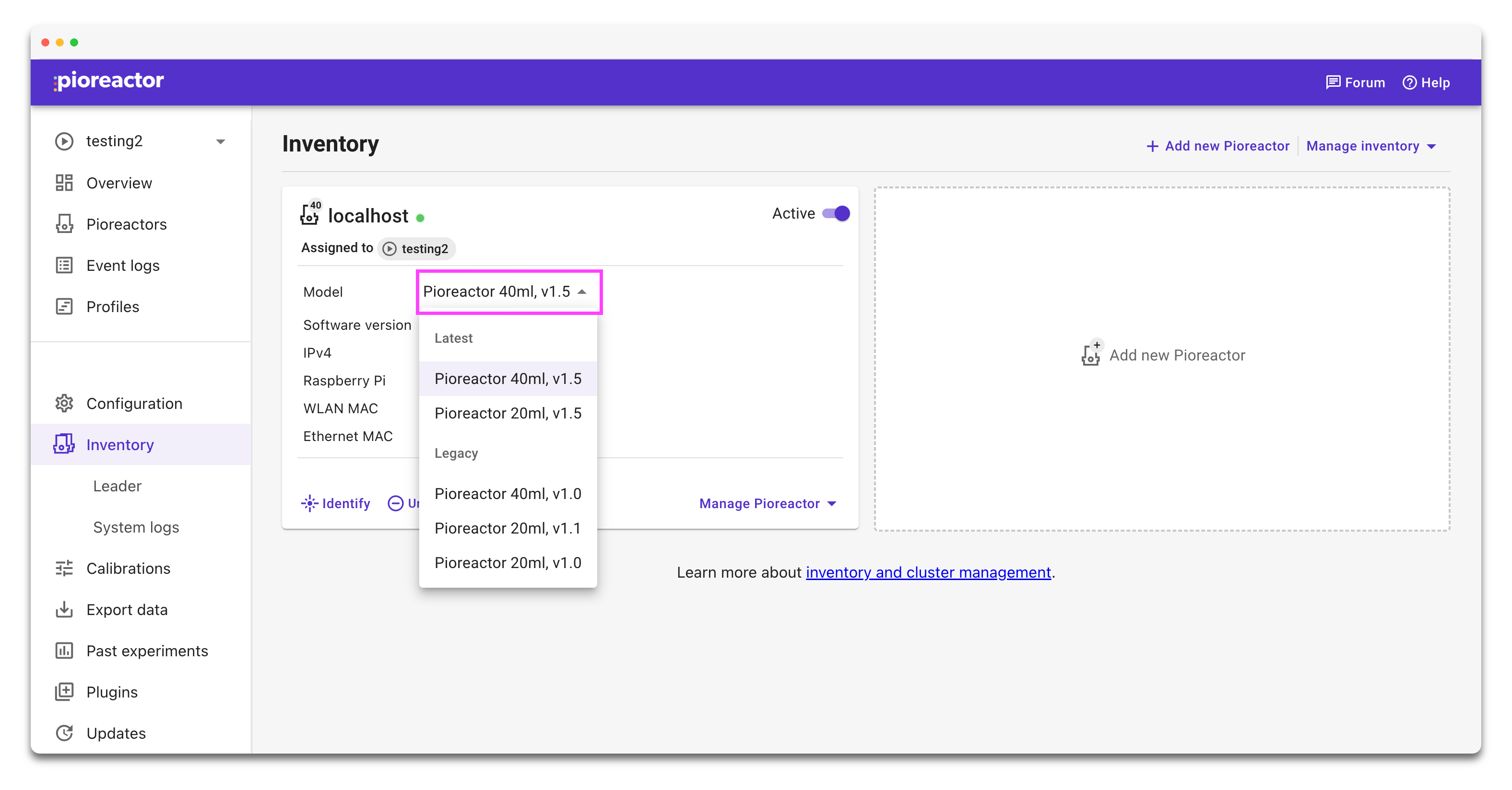

In the Pioreactor UI, open Inventory and update the Model dropdown for your Pioreactor to the correct v1.5 variant.
