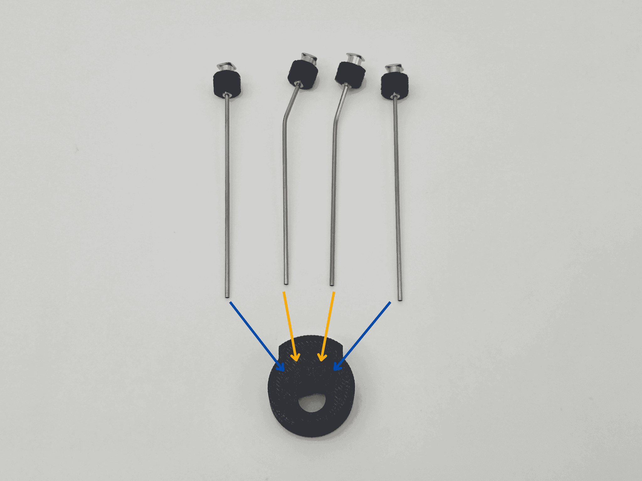

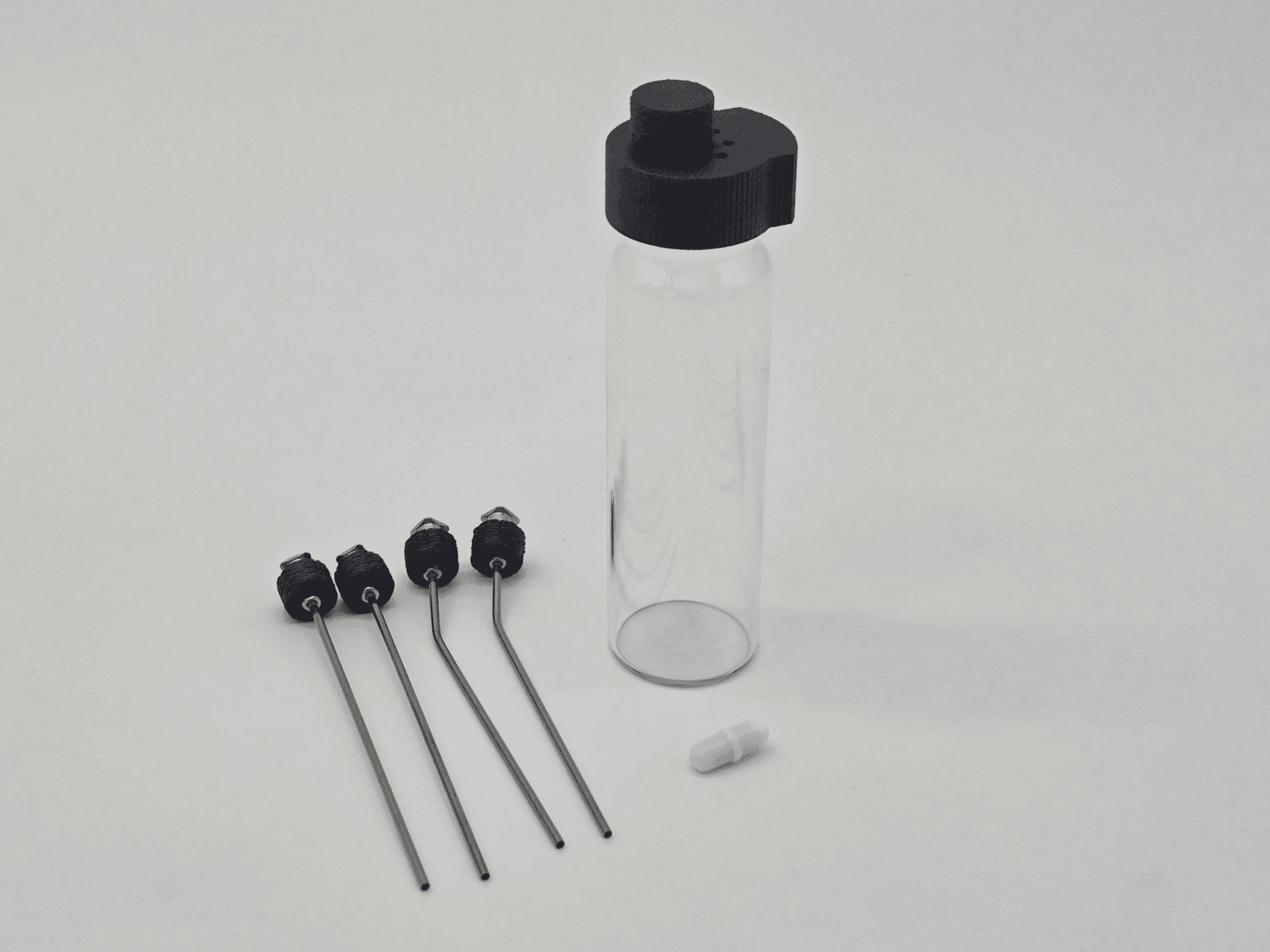

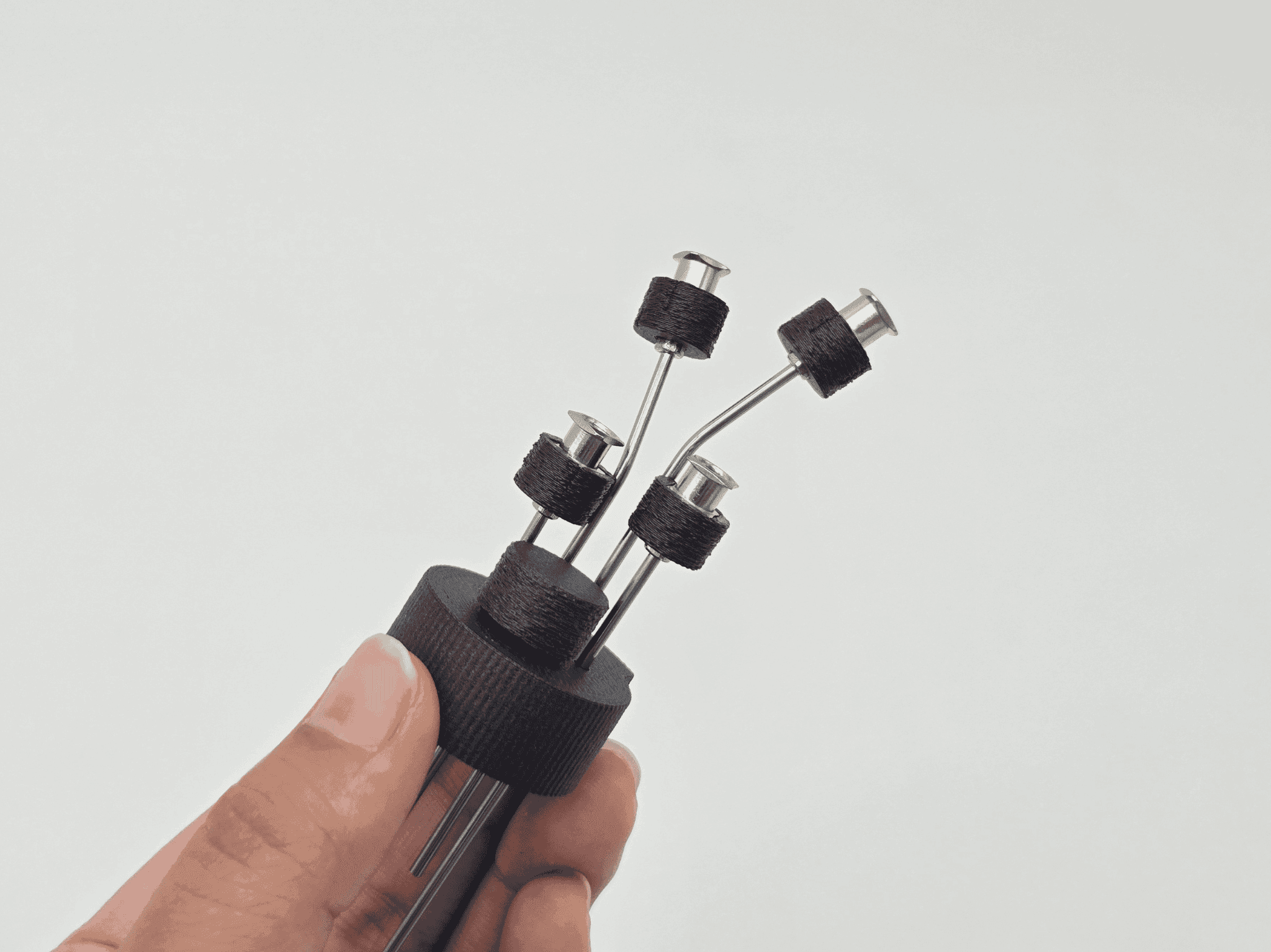

  1. Gather the 40ml vial, stirbar, and stainless steel ports.
  2. Remove the cap from the vial.
  3. Gently but firmly push the stainless steel ports into the four holes. The two straight ports are placed in the outer holes, and the two bent ports are placed in the inner holes.
  4. Place the stirbar in the vial and secure the cap.

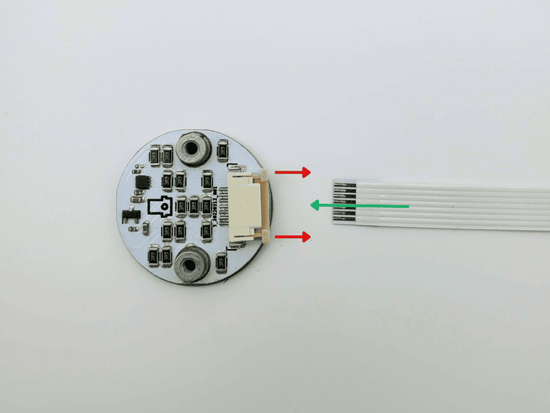

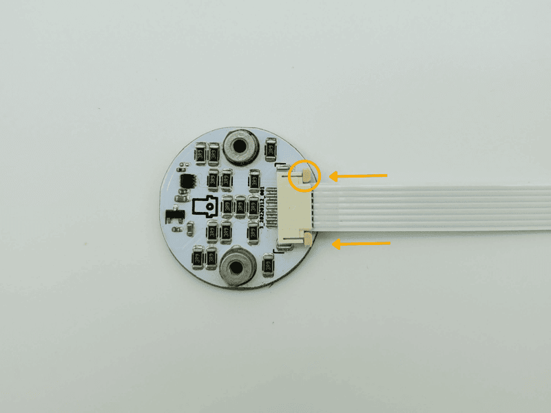

Step 4: Connect the flex cable #
  1. On the heater PCB, locate the white-&-beige cable connector, pull the beige-colored tabs outward to open it.
  2. Insert the flex cable blue side down, copper side up, into the cable connector.
  3. Then push the beige tabs back in to secure the flex cable.

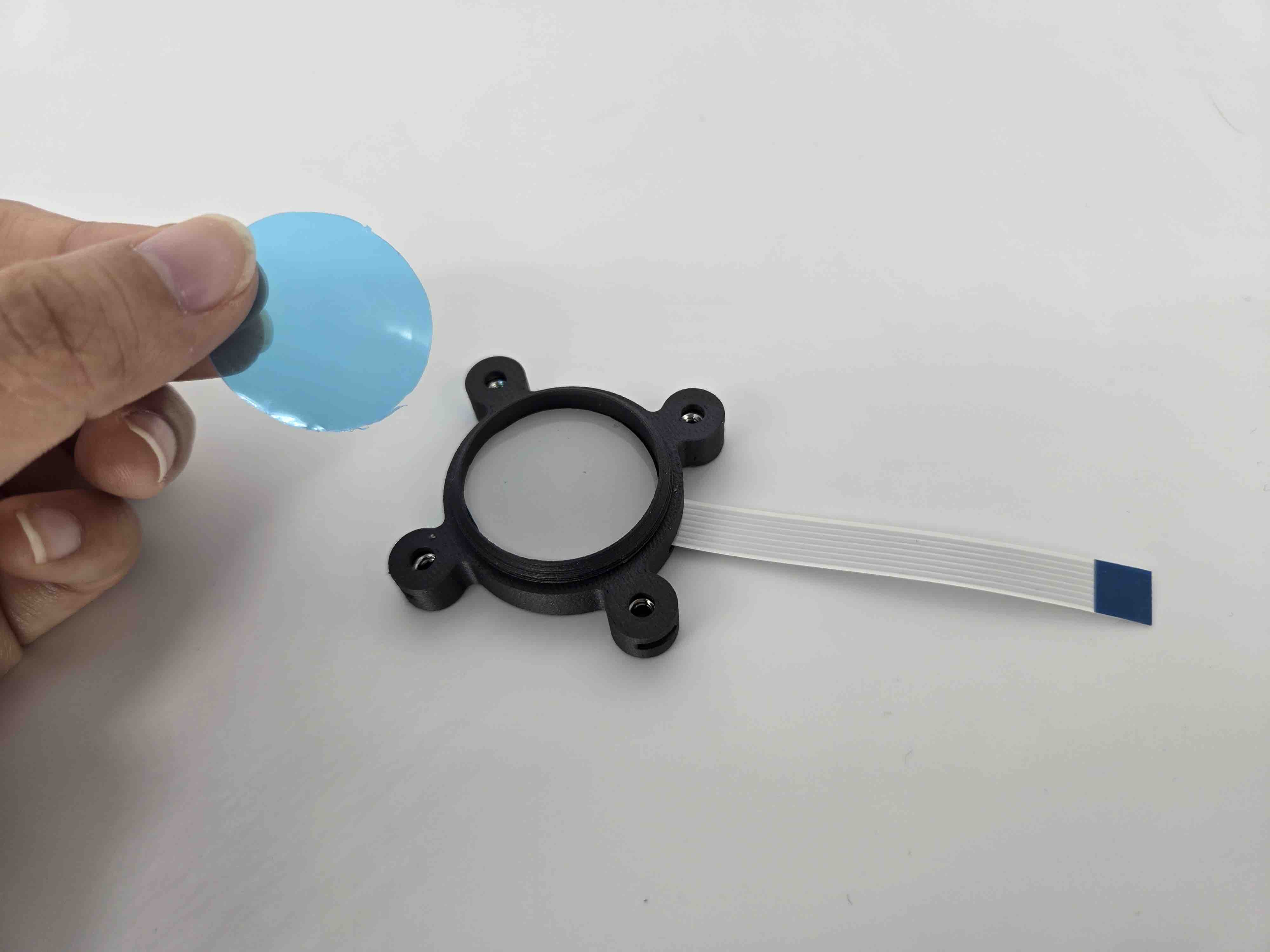

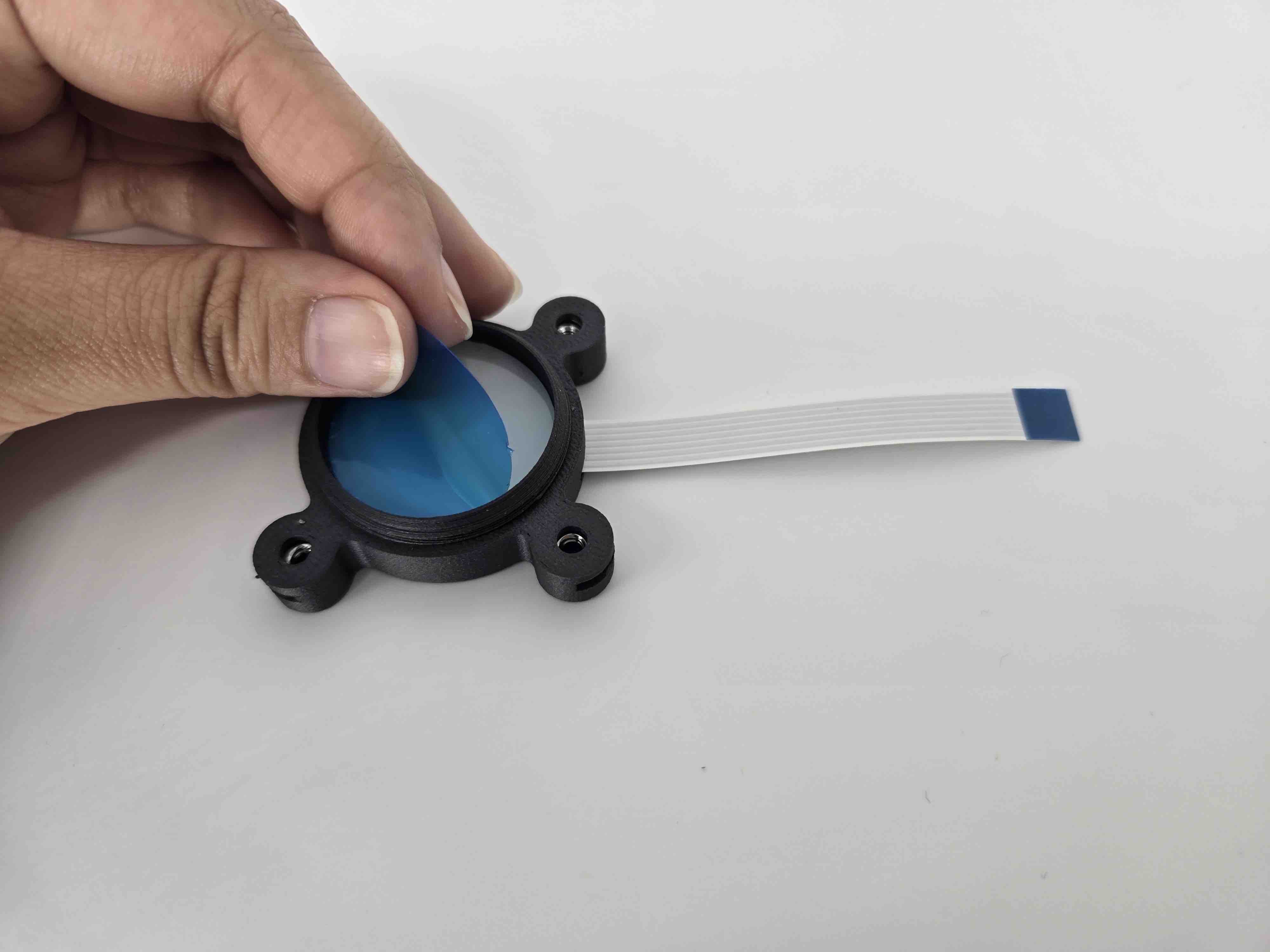

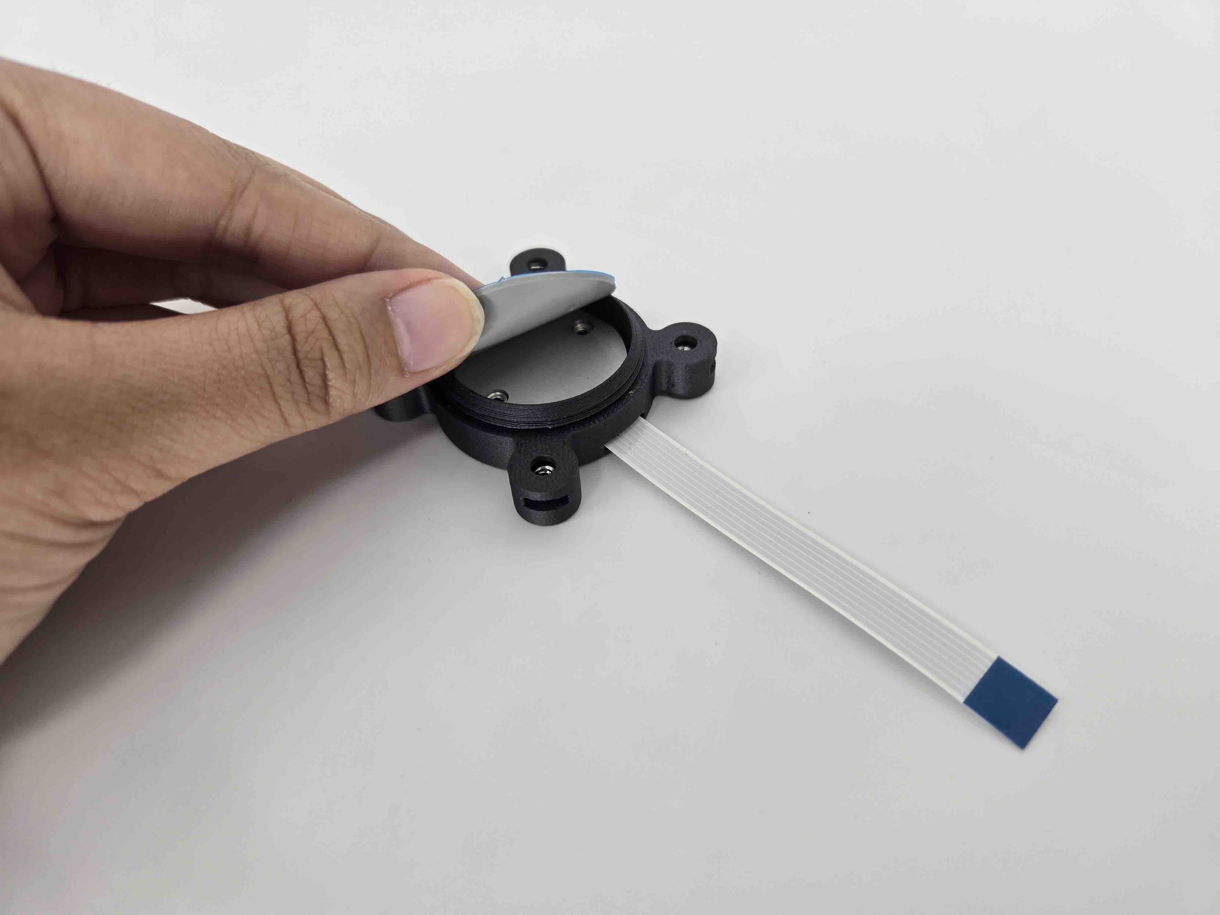

Step 6: Placing the heating pad #
  1. Remove the clear plastic from one side of the thermal pad. This exposes a sticky side on the thermal pad.
  2. Place on the flat (aluminum) part of the heating PCB. Lightly apply downwards pressure to secure it and remove any air bubbles trapped..
  3. Remove the blue protective plastic on top of the thermal pad.
